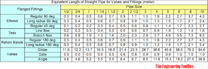

A 76,000 BTU/hr modulating burner may need a dedicated 3/4" line run back to near the regulator/meter rather than sharing it with a 60,000 BTU/hr furnace, but if it's the first branch off the tee from the meter it'll probably be just fine. (f the pipe diameter is 1" O.D., you're looking at 3/4".)
Note, these are "equivalent feet"- the equivalent lengths of the ells & tees have to be added to the lengths of straight pipe.
