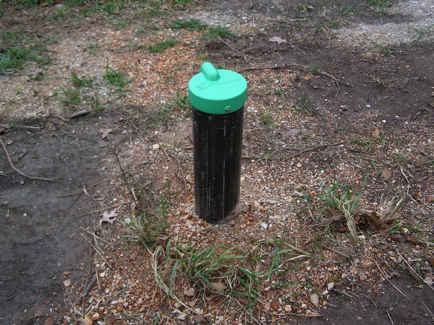

I got my well drilled last Fall. It's 170 feet deep, cased to 105 feet, and water level is 50 feet. I'm in SW Missouri in the Ozarks.
Here's what I have right now:
I would like to get water to my (non-heated) barn, which is 40 feet to the East of this well, and sometime later get water to my house site which is going to be located 80 feet NW of the well. The house site is about 10 feet lower in elevation than the well and the existing barn. I have a good deal of construction experience, and am capable of building a good wellhouse, but do I need a wellhouse? Ideally I'd like to get water to my barn this Spring, but I won't start construction on my house for another 2 years.
Is there some way I can put a pressure tank in my non-heated barn, and be able to drain everything in the late Fall when temps drop so nothing freezes up, and then be able to turn the water back on in the Spring without building a wellhouse?

If you have the pump down the well you don't need to put anything over the well. Just run an appropriately rated wire from the barn to the well, sized for minimal voltage drop at the required current. Also bury the water pipe below frost depth. Code dictates a minimum depth for the electrical. Use pitless adapter to bring the water out the side of the well casing at the depth you want to run the pipe. Use nice big black flexable (sort of) pressure pipe. Probably want 1.5" or so. Bigger is better to minimize pressure drop.
Tank and pressure switch go in the barn. Leave drain valves at low points to drain everything. Maybe put something at a high point to let you put in compressed air for blowing out the system with fewer drains. Try to avoid making low points in the plumbing.
When you get the house done you just move everything. Or build a protected space with some backup heat around the tank and pipes in the barn and run more buried pipe.
If someone here would comment on the proper use of a check valve. It would seem useful to have a check valve before the tank and pressure switch rather than have one at the pump. Then a valve on the pump side of the check valve would let water drain back into the well.

You say to "leave drain valve at low point". How can I leave a drain valve below the frost line, and have access to it?
I'm not plumbing the barn, only running a water line for a single faucet.
Ideally I'd like to just put one of these (don't know what they are called) near the barn entrance and be done with it, but I can't figure out how to do that with no well house and no bladder tank. Any ideas?

I am talking about low points for the above ground stuff. Tank, pressure gauge, pressure switch.
The device you are talking about actually drains water from the above ground piping when it is turned off. So you can leave them outside without freezing. But that is no real help for your problem.
The underground pipe from the well is protected, but it has to come up for all the other stuff. If there is no check valve at the pump but there is one before the tank and pressure switch that will let the whole pipe to the well to drain. This is not necessary to protect that pipe, but it will also drain the riser where it comes out of the ground in the barn.
Should you think about just putting the hydrant on the well pipe and then use a hose or adapter to the pressure tank; don't. If someone shuts it off and the pump runs will you will most likely break the pump.
How much water did the driller say your well can produce/hr? You have to decide what pump you are going to put in to meet your anticipated flow rates. The flow rate will be used to determine tank size. Someone will be along later to try to sell you a little valve that can minimize the size of the tank. It can be pretty small.
For a small tank, maybe you can dig a hole and bury it. Just put down a hole, line it with block or even pressure treated wood if this is temporary installation and you will eventually put the equipment in the house. Put a well insulated and tight cover on it. If the tank is below the maximum soil freeze level and insulated that should keep things OK. Someone else will probably have some knowledge on that. You could also leave a little heat source in there, but I would not personally feel safe with that approach. If power fails; not good.
There is also a real simple solution. Just run the well pipe directly to the hydrant. Keep it open and just run the pump when you need water from the hose/faucet. There are two problems with this. If the flow is low enough the pump may not be sufficiently cooled and be damaged. You have to figure that out for your pump and how you are going to use water. The second problem is of course running the pump with the faucet/hose turned off. This could break the pump and/or damage pipes. It is a low cost but risky approach and you have to have a use pattern that makes it work. I did that for about 6 months with my well before I had anywhere to put the tank and things. It worked for me with my pump. My pump only generates about 3 G/m so an unrestricted 5/8" hose was more that it could keep up with. It was rather a pain in the butt. But I was mostly just watering plants so it was not bad. This way you would have nothing to drain and no pressure switch or tank to buy until you have the house.

Actually, your last suggestion is not a bad idea, as long as no one ever shuts off that hydrant while the pump is running. Of course after the pump is shut off, you will have to close the hydrant to get it to drain or the hydrant itself will freeze.
You apparently already have a pitless adapter from the looks of your casing. The well driller could have put in an H2Optimal system that has larger casing at the top of the pitless. This allow for the pressure tank, pressure switch, and Cycle Stop Valve to be installed inside the casing. This is done a lot for stock wells that are out in the middle of nowhere and do not have a well house.
Since the well is already finished, you could use one of H2Otimal's Buried Tank Eliminators. This is buried next to the casing and has the pressure tank, pressure switch, and CSV inside and underground. This way when you are ready to hook up water to the house, barn, or irrigation, all you have to do is run the water lines. The CSV allows you to use a very small tank, and the BTE puts it all underground where it cannot freeze.
You could also use one of the Pside-kick complete pump control packages inside the bran or house. (See picture below) You would just need to install a stop and waste underground before the pump controls. Then when you need to winterize, you just turn off power to the pump, and close the stop and waste valve.
You DO NOT want any check valve in the system other than the check valve that is on the pump itself.

Valveman, there is nothing there but a hole in the ground, and the casing and the green cast-iron cap on the casing. All the driller did was drill the well and drive the casing, and seal it with some 3 bags of clay.
I like the idea of the Pside-kick pump control package as in the picture you posted. It looks simple and I like simple.

Hi Robert444
The well has a pitless cap and steel casing. I assumed the pitless was already installed and just plugged, because it is much easier to weld a pitless on before the casing is installed. Most of these type casings come with the pitless already attached at the correct depth. If the well does not have a pitless, then it has the wrong cap.
Without the pitless, you would need a well seal with a couple of holes for the pipe and wire to come through the top. Then even the well head would need to be covered and heated.

That green cap is one they had in the back of the drill truck--it was beat-to-crap and rusty as all get-out, and the 1/4-20 bolts that were supposed to hold it to the casing were bent. They just kinda threw it on top of the casing. I pulled it off, removed the bolts, put in some good bolts, wire-brushed it, primed it with Rustoleum Rusty Metal primer and shot it with some Safety Green I had left over from another job. And I did look down the well one dark night, with the help of a Mag-lite... there is nothing in the casing--I could see all the way to the water. I'm not sure exactly what a pitless or a well-seal is. I'll try to find out.

OK, I'm understanding more. Thanks Valveman. I just googled pitless and found out what it is, and also found out what a well-seal is. I think I'll go with a pitless, even though they didn't weld anything on to the casing that I know of. But it makes more sense for me to bring the water out of the casing below the frost line.
