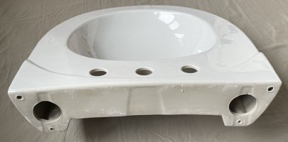

Hi, i am installing 4 wall hung lavatories for a commercial project i am developing. I got a great deal on the four sinks as they had been sitting the local plumbing supply warehouse for a while and were from a now defunct manufacturer (Crane). After purchasing i realized i have no idea how to install these sinks and can not reach out to the manufacturer (always a catch on these "great deals").
sink specs: https://www.craneplumbing.ca/assets/documents/crane/spec/SpecSheet_9624.pdf
anyhow, i thought i'd figured it out with these "lavatory carriers" from Watts: https://www.watts.ca/products/drainage-solutions/fixture-carriers/ca-462
but when i reached out to the regional Watts rep to ensure they would fit my sink i was told that i instead needed the "CA-311" or "CA-321" which are listed as "urinal carriers" on the watts website and seem less appropriate for the sink just based on the available mounting holes in the back (see attached image).
CA-311: https://www.watts.ca/products/drainage-solutions/fixture-carriers/ca-311
CA-321: https://www.watts.ca/products/drainage-solutions/fixture-carriers/ca-321
i confirmed with the rep that these are, indeed what they recommenced based on the same sink spec sheet linked above and was also informed that they have no product literature available for me to know how to actually use these to mount my sinks.
i would very mush appreciate any insight folks might have about how best to mount these sinks. specifically, how can i tighten any mounting hardware that is only accessible though the back of the sink (ie the small holes on teh top outside corners of the back face of the sink, which seem to be the onles that would work with the CA-311 or CA-321).
