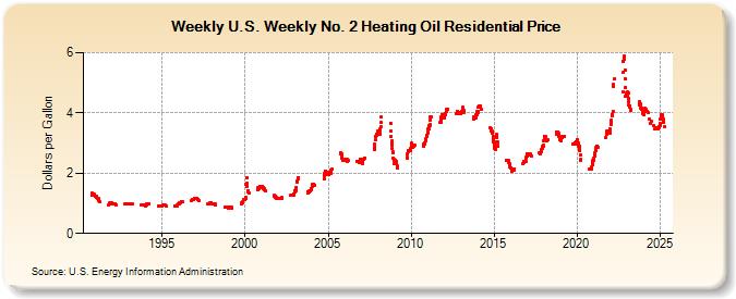

When heating oil has been under $2 for at least a year, let me know, eh? :) Last I looked it still has a way to go.
It might hit $3 if Europe goes off into full recession, but at $2 price point it will kill the frack biz, leading to another price volatility round when the world economy rebounds.
And $2 heating oil is what it would take to be anywhere near competitive with natural gas in New England- either that, or natural gas at $2.50/therm, delivered, which would be about 2x the current price in MA, where it's more expensive than the national average due to those pesky pipeline/storage constraint issues.
As long as crude oil is expensive enough to support the shale oil biz, we'll be swimming in cheap natural gas. If oil prices drop below that oil-profitability point for very long, natural gas prices will rise.
That point is estimated by most industry analysts to be somewhere between $75-100/bbl. (Some of that shale oil isn't profitable RIGHT NOW, even if some of it is still making something.)
But for now, the price trends on oil and refined products makes for happy (or at least less-unhappy) consumers. Price volatility works in both directions. I'm not expecting $2/gallon heating oil (if it ever hits that point) to be a sustainable price unless the world stops driving internal combustion cars.
The last time heating oil was running two bucks was about a decade ago, when crude oil was trading at ~$30-40/bbl:
Even some of the OPEC countries couldn't pump it out of the ground profitably at $30-40/bbl, but some could. Only severely curtailed world demand would balance with the pumping capacity still profitable at $30-40/bbl.
To re-work some of those fields for faster pumping rates would require massive infrastructure investment in those projects- it's easier and more profitable for the OPEC countries to just let the marginal cost of the tough-t0-get goods such as shale oil drive the world prices, since it triples or quadruples thier profits without having to invest much in their own resources.
So, enjoy the modest reprieve in prices while they last. The bottom price is still much higher than we would like, the way it was back the "good old days" of oil a decade or more ago.

This is well understood- it means higher prices for electricity in the near term, but not an earth shaking prospect for those heating with natural gas. Residential retail natural gas may hit it's 2008 peak again, hitting the $1.70/therm range, but that's still significantly cheaper heat than $3/gallon heating oil.
$1.70/therm is $17.00/MMBTU (source fuel content)
$3/gallon oil is about $21.70/MMBTU (source), or about 28% more expensive than $1.70/therm gas. Even $2/therm gas (a price never seen in MA during winter, though it came close in January 2006) is cheaper than $3/gallon oil.
$2/gallon oil is about $14.50/MMBTU, which would mean $1.70 gas would be 17% more expensive than oil.
Let me know when heating oil dwells in the $2 range for a few successive heating seasons so's I can remember to sharpen my ice skates. :)
