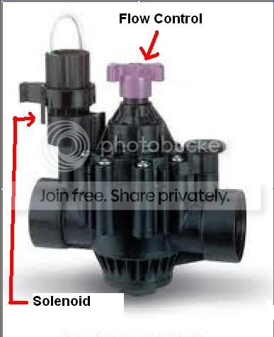

    I think zl's suggestion is the most likely. Valves have diaphragms that open and close based on the pressure differential above and below (which is irrelevant to this discussion) so, if debris gets in there, they can't close off. Replacing the controller wouldn't help with this problem at all but buying a new one after 20 years would probably be a good idea anyway.
    I'm assuming that your valves are electrically activated and not hydraulically, right? There are wires coming out of your controller and not little tubes, right? If this is an electric system and you can find the individual valves (should be in boxes), you can turn them on manually and then close them down to see if they close readily. If not, it's crud inside and you'll have to take the top off and clean them out.
    To open manually, there will be a bleed valve close to the solenoid that you can open and close. It might look like a little screw or a lever. This is not the flow control valve. If your valves are as old as the controller, it's possible you won't have these.
