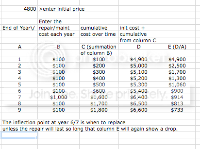

My HVAC systems are about 18-19 years old. Maybe no need to rush to replace the new systems even if I have to spend small amounts of money for mainatence and repair each year?
I have a spreadsheet on my other computer that tells when to replace equipment. It's one of many equipment replacement strategies but this one does not take The Cost of Money into account.
Now that I know how to post a "print screen" I'll try to find the thing and post it.
With this and the expected lifetimes of equip. I think you can make a pretty rational and informed decision about replacements.
