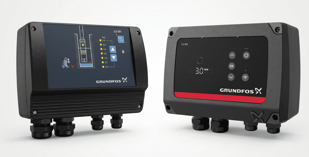

I personally only know one person that has a sqe with a cu 301 controller, and he sets aside $5k every few years for service. The pump is only 7 years old, and is the only original part still going.

With the CU301 the pump is called an SQE and will vary from 3K to 10K RPM. Without using the CU301 the pump is called an SQ and will run at 10K RPM all the time after ramping up to full speed a few seconds after the pump is started. The SQ seems to be fairly dependable and spinning at full speed all the time is a good thing. The CU301 controller is what gives the most problems. The CU301 is also what varies the speed between 3K and 10K. Going through all those different speeds causes every component in the pump or motor to go through their mechanical frequencies, which causes vibration. It is much better to just let the pump spin at full speed all the time.

This particular controller is the CU302.
Aside from bluetooth and wifi Im not sure what other (if any) differences there are between the 301 and the 302.
I suspect next CU 301 failure will be replaced by a CU 302. It may or may not be more reliable, but it does not need the Grundos programmer to program it. The user can install a phone app.
