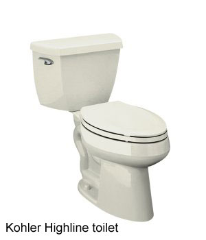

I am looking for an eco friendly pressure assist toilet to replace a poor working Kohler Wellworth. I've narrowed it down to these choices:
1. Kohler Wellworth Pressure Lite (3531)
2. Vitra Evergreen toilet
3. Crane Ecomiser (38350)
4. Crane Economizer 1
5. Mansfield Quantum One (148-153)
6. Kohler Highline (3519)
Anyone have experience with these toilets?

Why would you want a pressure assisted toilet when there is an Toto Eco-Drake toilet that delivers a 900 grams of solids per flush with 1.28 gallons of water?

A couple of questions for you. Why do you think you need a power assist toilet? Are you still assuming all low flow toilets perform as poorly as they did when they first came out? If so, you need to do more research on the topic. Hang around here for awhile, you might find it very interesting. Second, where did you come up with your list? None of these are quality brands anymore. If you want a quality toilet that will do the job for you, get the Toto as Redwood suggests. You don't need a power assist toilet nowadays.

Kohler makes this one that I sell
http://terrylove.biz/home/47-kohler-highline-classic-ada-pressure-lite-toilet-k-3493.html
Performance between pressure assisted and large valve gravity are similar in test, and in use.
If you like the idea of pressure assisted,
Gerber and Kohler are mentioned often as good pressure assist toilets.
I'm not a fan of the dual-flush pressure assist. They seem too glitchy.
You can get single flush pressure assist in 1.1 and 1.6 made by Flushmate
and a dual flush 1.1/1.6 made by WDI
I won't sell their dual flush.

Thanks for the advice Terry!
A family member recommended the toilets above, so I thought I'd check with you guys.
After careful consideration and looking at the MaP reports, I think I'll go with the Kohler.
