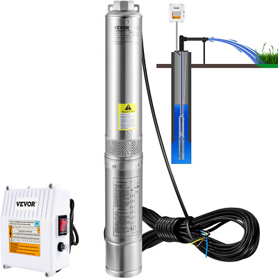

This is great info, Cary, thank you! I wonder if it would be better to go cheaper on the pump for now during the testing phase to ensure I'm not dropping $1800 on a pump that won't work at 400' (if I discover I would need to go deeper into the well). Does that sound right?

Might even look at something really cheap just for testing. I found this quickly. There are probably better choices with time to look.

Perfect. I'm assuming I can just restrict the flow with a valve or something similar to keep the GPM at the outlet (into the cistern) to around 3-4?
Also, with the size of the casing (6.25") compared to the drop pipe, I'm thinking that I should still easily be able to get a string and floating device down there to measure the level, don't you think?

You can restrict the flow down to as little as 1 GPM if needed for testing the well without hurting the pump. A string and a weight will just get stuck in the drop wire and pipe. Use a 1/4" poly tube for and air line and you can tell exactly how deep it is to water.
