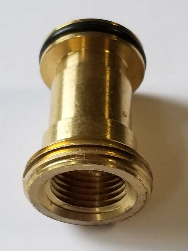

Some tub spouts are the cause. When the diverter is pulled up on the tub spout, does water leak into the wall? That's also a common one. A new tub spout is often my cure. I favor the Delta spouts with their weird adapter as that let's me use a pipe nipple or solder onto copper. A good slip spout on copper also works. Moen makes a good one.

Delta tub spout adapter. Takes either a threaded nipple, or can be soldered to copper pipe on the other end.
