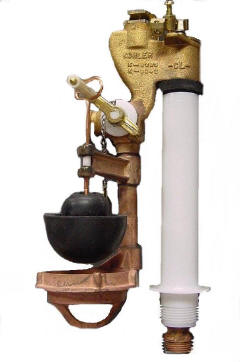

    I have (6) Kohler Rochelle toilets in my house... and I'm wondering if they might be the source of the groaning, moaning, vibrating noise that occasionally occurs at random times.
    I'm curious to know if there are any "NEW TECHNOLOGY OEM REPLACEMENTS" for the Ballcock assembly that is inside the tank. This one currently uses the float ball on a long rod / arm.
    I've attached a picture of the current assembly. I'm wondering where I might find either an OEM Replacement, or a newer style that might be more reliable??

    rebuild kit exists
    You can get it from a plumber or Kohler, it is part 30668. Don't throw away the old parts - they are actually worth something. I for one am willing to pay for the lift wire, my sister threw away the old one and the new one has too light of a gauge. Ack!

    Remove the tank ball, and then "loosen the bolt" underneath it. Once it is loose enough you can lift and slide the flush valve to one side, work one end of the "toggle bolt" out of the hole and then slide the other side out also.

    I do NOT see part number 51419 (Seat) listed on you replaced parts list. This seat can be removed with an allen wrench (not sure of the size). If the very top of this seat is not totally smooth, the water will not shut off completely. Put your finger on it and twist it around...maybe you will feel a "burr". Even if you DON'T, I'd replace that item first. Also if the level of the water in your tank is too high the water will continue to run into the rim around bowl. See if the water level is above the "hole" in the front of your tank. There is a short hose that runs from the unit into the rim of the bowl. It is up high...at the water level...and runs frontwards towards the front of the toilet into the rim around the bowl. That's the rim with all the little holes in it...you can feel them by running your hand under the rim.
    Lastly, if part number 51428(Cap & Float Lever Assembly) is not totally clean, the "plunger" will not slide up and down easily. This could cause that problem, which say can be fixed by lifting the ball up.
    Take that part off the clean the "hole" with a stiff brush using Brasso, or some other brass cleaner. Sometimes a build-up of calcium-like crud can form there. For a brush, go to a auto parts store and buy a cheap spark plug adjuster...sometimes they come with a brush. Call Autozone and see if they have a brush like that. If the hole is clean, the o-ring will make good contact with the sides. Good luck.
