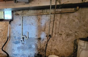

A photo

So if you on the floor above you add an AAV for the kitchen sink, and you move the standpipe to the right to allow room between the san-tee and the trap to add an AAV on its trap arm, the existing kitchen sink drain routing is fine, assuming that elbow in the upper right of the photo is a LT90. The standpipe needs to be at least 18" in length.

Thank you. So I should cut the laundry trap arm and use a san-tee on its back to give a vertical dry vent riser for the AAV? And then I can replicate the kitchen drain underfloor in 2" with long sweep 90s on both ends and come into the top of the vertical vent as the old 1 1/2" was? I'm fairly comfortable with the undersink layouts, but I've generally contracted out the drain layouts. Thank you very much for the guidance.
If I wanted to add a cleanout to the end of the kitchen sink run in the basement, what's the best combination and orientation of fittings to do that?

The most likely place for a clog is where the flow goes from vertical to horizontal. That turn should be a long sweep or 2 45s. My first thought was to put a combo (combination of a wye and a 45) where that bend is now. Let the extra port be a cleanout, but that only lets you go one way.
Putting the long sweep there with a 2-way cleanout on the horizontal run would let you run the snake both ways.
A cleanout above or below the santee of the kitchen sink would be good.

Ah, I thought you were suggesting the 2-way cleanout instead of the combo or LT90. A 2-way cleanout on the horizontal after the LT90 would be hard to access given the height of the horizontal. I think the combo is the conventional solution.
Cheers, Wayne
