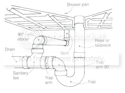

The tub and shower are still not vented. The lavatory uses an illlegal "S" trap. You cannot use sanitary tees under the floor. And I would not use 1 1/2" laterals. Other than that it is okay.

FixItPeter
13
Also, you indicate that a sanitary tee can't be in the floor... here's an image of a shower pan utilizing a san tee ...
Could you explain that?
Thanks, Pete
Prashster
936
In my town that latest shower pic would be LEGAL only if that vent is dry; ok to use sanitary tees for dryvent-to-drain connex's.

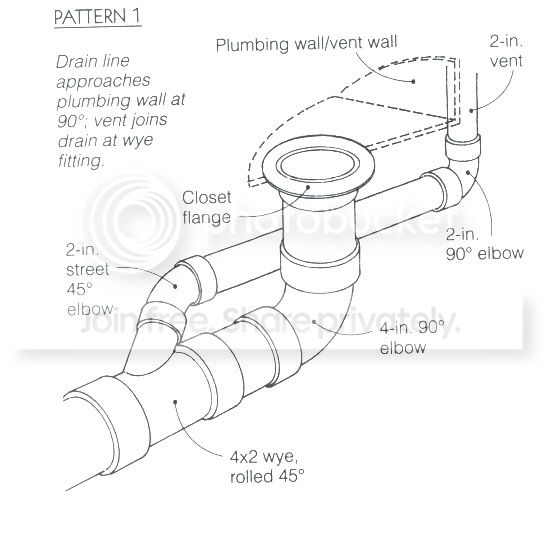

Well, after many many many versions... I think we are much closer to RIGHT way...
Please, be patient with me and let me know what you think:
(Now that I look at the picture some more... I wonder if I could send the vents on the WC and the SHWR our to the left. Less of a lateral run for the vents...) -- Just a thought.
This picture *I* made... so *I* can change it as the ideas/recommendation change.

Prashster
936
Vents are not supposed to take off horizontally (<45 deg) from the drain. When water is draining down the shower and toilet, how's it gonna know to go down the water and not down the vent? Even with some slope, high volumes of water will block a good portion of the vent unless it takes off from the top.
I think the only exception to this is the toilet, which can be rear vented upstream of the closet bend. Why don't you vent the toilet back up the rear wall, and run the shower drain under the partition wall so you can have a vert takeoff? I posted a pic earlier. What's the prob with it?
Also, I'd tie the vents together in the wall of this story b4 going to attic. This'll save some plate penetrations.
FixItPeter
13
pr,
The wyes that you see there wouldn't be horizontal. They would be rolled on 45*. Like you see here:
I'll go back and look at your pic again...
