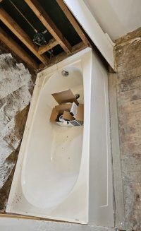

Plumber installed this Sterling Performa tub -said they normally don't install tubs, just make the connections.
Major concerns about the tub casting and the install as follows:

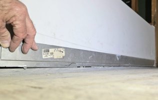

1. Bottom edge appears to be a mfg defect -sits proud in the middle, and not a true edge -see 3 related pics. In one pic, the straightedge sits on 2 nails stuck in gaps on either end to show how far out of whack the edge is.
2. Appears that the edge not finished to proper height: tub sits high on front edge and feet along outside edge don't contact the floor -see 5 related pics.
Regarding legs -on either end they can be accessed to shim, but shimming the middle legs (likely highest stress area) would be a trick.
3. Instructions direct that tub be set in a 1-2" mortar bed. There's no mortar bed.
4. Instructions direct metal support clips be installed at each corner. There are 3 along the back, and 4th clip uninstalled -see pic.
5. Instructions direct that plastic attachment clips be installed. None installed.
6. Not familiar w/Vikrell, though apparently it's been around awhile. Aware that proper support/mortar is VIP to avoid acrylic tub cracks -apparently Vikrell is more crack resistant -enough so that mortar/leg support is not as critical?
Appreciate any responses regarding-
Correct that this tub is defective? Should the installer be asked to replace it?
What is your perspective on the mortar and clip concerns?
Thanks for your time!

No Nothing wrong with it . coulda took a grinder to bottom edge but whats the problem ? definately not a defective tub
I set mortar underneath regardless of manufacture instructions well not every time because it is extra work but i prefer it .
definately is a differance between perfect world , perfect job and typical work or good enough. techniocally it dosent meet manufacture instructions , often i install a ledger board under the long wall as well but not so much on acrylic , fiberglas vikerel whatever you want to call it , installed dozens have had hundreds of figerglas set by manufacture crews and those guys do thier own thing but generally set them pretty solid .
I have had to or felt i needed to beef up the installation and cut blocks of wood on a taper and and slid them under tub to make a tight fit to avoid resetting tub pushed mortar under neath etc .
discuss the matter with your contractor / trademan

The tub sits on the middle of the bottom edge: pics show the left side 1/2" proud of the floor. Does "Nothing wrong with it" mean you normally/frequently see the bottom edge that far off?
Do you just scribe a line and grind it?
How do you know where to scribe the line, to ensure the edge sits true AND the legs contact the floor?

I am not a plumber and do not have 2% of the knowledge of other folks on here. I have installed 2 tubs in my own house, but not that brand. I would not be happy with that install. The instructions regarding mortar, attaching it to the wall, etc should be respected, if you want the manufacturer to honour your warranty. If the tub is not level (I don’t think yours is close), you may have trouble installing the walls, especially if using pre-fabbed walls. The tubs I installed only had 2 legs both of which needed to be supported. I would think all of your legs should be supported, but would suggest reaching out to the manufacturer regarding specific installation instructions for that model. Also, the bottom edge of the apron sure looks like a defect or jobs site damage to me, but that is not a brand I have used.

Noted that <12" of the apron is in contact with the floor at the center, and the wide gaps esp on left side.
Their response was that the apron is "not intended to be load bearing, but should not have been installed if the flooring can't cover the gaps". They didn't support my perspective that the apron edge, which also sits proud/raises the tub to prevent the outside row of legs contacting the floor, is defective.
Pushed back on "not load bearing": people sometimes sit on the edge of their tub, and suspect the edge is normally stood on by many installers when caulking the surround. Regardless, they stood by "not load bearing"!
