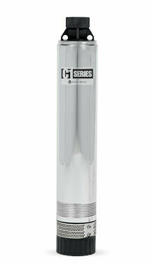

Am I on track looking for something like this?
Stay away from those so called "cistern pumps". The intake on the bottom leaves much less room for the motor, and it is not as robust as a regular water well submersible. A 10 GPM, 1/2HP is a good size, just need the intake in the middle. A cheap cooling shroud or flow inducer sleeve will make it draw from the bottom and keep the motor cool.

Franklin makes a good submersible motor, I just don't like what they have done to their pumps. A Goulds or Grundfos is a preferable pump end, and work well with a Franklin motor, which makes my favorite combination. For the price you can't beat one of these. https://www.ebay.com/itm/290825831348 Might seem like overkill but can still be restricted to 1 GPM if needed. They also make a good booster pump for in the cistern as in the drawing above.

Thanks so much! Due to the silt and most likely substantial accumulation of it at the bottom of the tank, I would prefer to pump from higher up. Do all the deep well pumps need a flow inducer to work?
Wow, that's a good price. Can I run this as is or otherwise rig it up to not pull from the bottom?
Can you buy motors and pump ends separately?
Flow inducer will double the life, but it will work without it. Can hang pump from top like in a well or lay it on a cradle raised off the tank bottom.
Good price, but needs an added check valve. The built in check valve is no good. Extra check valve is half the price of the pump. Lol! Pumps and motors come separately, just don't know about that brand.

Saw that in the comments! I assume this pump will work with a CSV?
