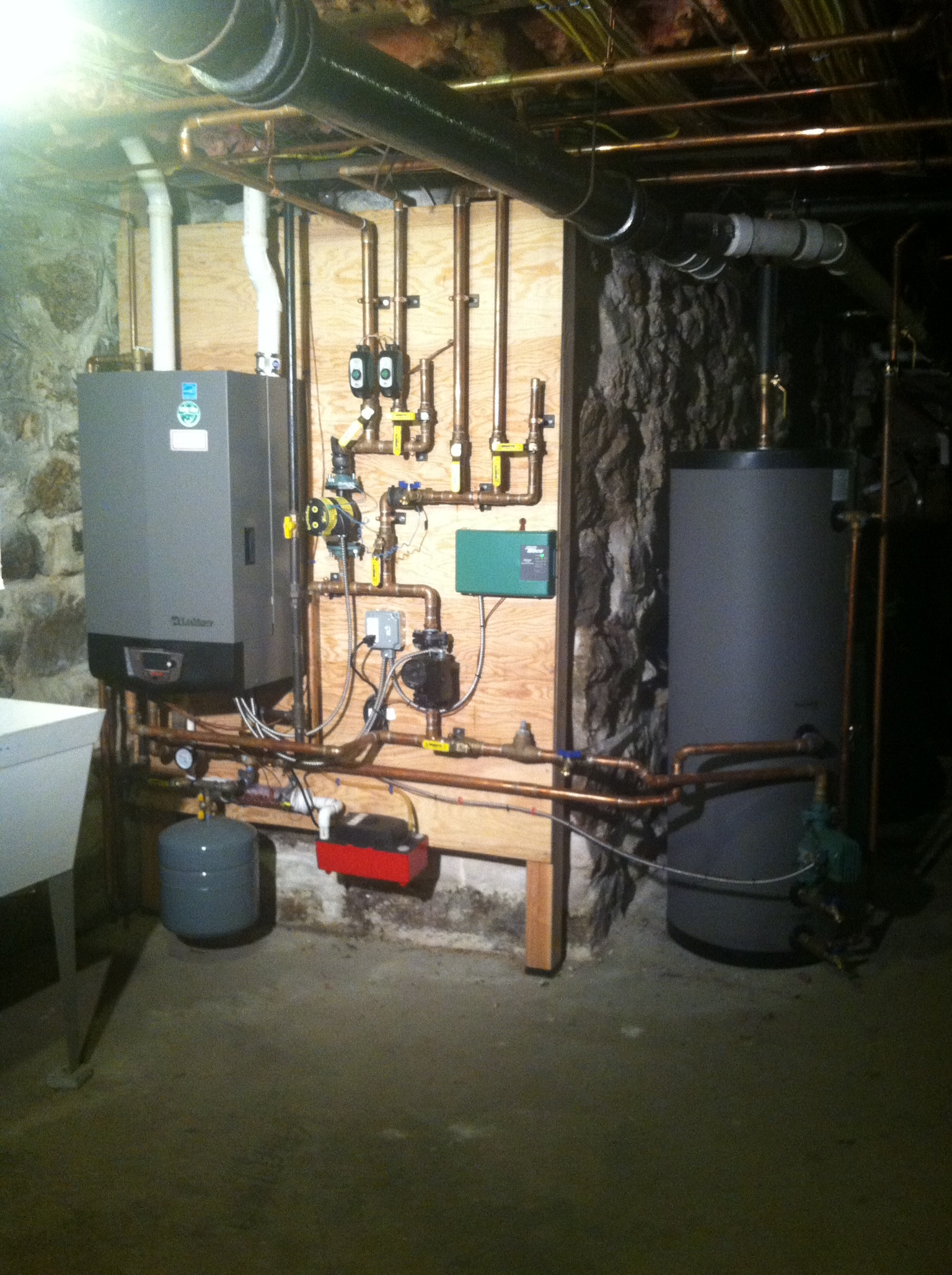

Last fall I had a new modcon boiler serving two fin-tube baseboard zones. I have a couple questions regarding the current circulator pump set up and whether it could be improved.
The system is a Lochnivar Knight WH55 boiler with Grundfos pump (UPS15-58FC) on the primary loop and a BumbleBee pump (Taco HEC-2) with temperature delta T sensor on the secondary loop with two zone values. There is also a DHW priority loop with indirect tank.
The delta T on the primary loop is typically less than 5F even with the boiler-manufacturer-supplied Grundfos pump set to its slowest of 3 fixed speeds. Consequently, given my outdoor reset curve (which is low enough, maintaining two-hour long burns) the boiler doesn't condense when the outdoor temperature is below 45F or so.
I recently asked the installer about improving that, and he proposed installing a Grunfos Magna variable speed circulator that uses the boiler's 10vDC output to maintain a 30F delta T. It's probably not worth the four-figure installation quote to gain ~5% in heating fuel efficiency, but perhaps the replacement pump would also save some electricity(?) and of course I'd like to see the boiler operating at its advertised 95% efficiency in months other than May and October.
Also, I don't understand the point of having a delta T control on the secondary loop. Currently the Bumblee pump is set to maintain a 16F delta T. The observed effect is that the circulator runs at one of two speeds: initially at 13.4 gpm when there is a call for heat, then once the loop warms up, at a steady 6.8 gpm whether 1 or 2 zones are on. My impression is that the increased speed is overkill and does not affect the amount of heat delivered to the baseboards. Is that true?
Any thoughts on whether the installer's proposal is a good idea or are there cheaper alternatives? Also, can someone explain how maintaining a large delta T on the primary loop would affect average temperature and the delta t on the secondary loop? Should a different control mechanism (or none) be used on the secondary loop?

The WH55 isn't likely to be ridiculously oversized for the heat load, but based on the symptom it's probably oversized for the amount & type of radiation. (The min-fire input to the thing is only 11,000 BTU/hr, which isn't exactly the roar of a fighter jet on it's take-off roll, eh? ;-) )
How much baseboard (and size/type) is there on each zone?
With more radiation on each zone the delta-Ts will increase some, and the outdoor reset curve can be lowered without causing short-cyling behavior, but it has to be done in a measured fashion.

I'd like to clarify that there are no problems or comfort issues with the system, nor short cycling; I'm just interested in optimizing condensing efficiency, within the limitations of the existing distribution system.
The distribution system is 140' of finned tube baseboard (mostly 30 years old) divided into two zones of roughly equal size, one for each floor. Design-day heat loss calculation is about 43K BTU/hr (using Dana's degree-day method, and in the ballpark of the building energy model). I think the heat loss for each zone is comparable, maybe a little higher for the first floor due to open staircases.
(For some reason the plumber decided to increase the diameter of the supply and return pipe to the second floor zone, which is split, from 3/4" to 1". I think a consequence of this is that the second floor's calls for heat take priority over the first - as in 15 minutes vs. 2+ hours to satisfy. I've just tried closing the ball valve on that zone partway to see if that will balance things out better.)
I could probably dial down the outdoor reset curve a few degrees to improve condensing, but in my observation that will not improve the delta T on the boiler loop. Do you not think a slower, variable-speed primary pump would help?

More napkin math:
Min-fire output is about 10,500K, figuring 70' of baseboard on a zone that balances at 150 BTU/ft of baseboard, which takes an average water temp of about 110F. That's about as low as you can go with fin-tube baseboard to have anything like a linear output with average water temperature (maybe a bit into the non-linear range). Even at a delta-T of 3F that's well into the condensing zone, delivering something like 95% combustion efficiency there.
Expanding the delta-T to 30F would buy you maybe another 1% in combustion efficiency, but the non-linear output of the last 30 feet of fin tube on the zone would be all too apparent with a return water temp of 90-95. If you replaced the lower temp half of the zone radiation with an equivalent amount of panel radiator you would still maintain reasonable temperature balance, but not with fin-tube.
A single zone load 10K when the reset curve is delivering 110F AWT, is when the whole-house load is roughly 20K, or half the design condition load. Assuming an outside design temp of 10F and a heating/cooling balance point of 65F, that's a 55F delta-T when the load is 43,000 BTU/hr, so your load ramp is about 782 BTU/hr per degree-F. That means the load is at the fairly radiation balancing 20K, when the outdoor temp is 65F - (20,000/782) = 39F. Below that outdoor temps you'll need water temps to rise a bit.
At design condition you're looking at 43,000BTU/hr over 140' of fin tube, or about 300 BTU/ft. That's going to take an average water temp of 135F. With a 20F delta-T you'd still be in condensing mode, but is it really that important? At your average mid-winter outdoor temp of ~30F your heat load is about 27,400 BTU/hr which would be about 200BTU/ft, which can be delivered at an AWT of a bit under 120F, which even at a very low delta-T is still in the mid-90s for combustion efficiency. It looks like tweaking the reset curve as low and still as it can go WILL get you there, even without expanding the delta-T
On a bang per buck basis rather than spending money on fancy pumps to bring the system efficiency up, spend it on insulation. Looks like you have about 6 miles of exposed distribution plumbing down there that is one big convector/radiator dumping probably more than 1-2% of the boiler output into what appears to be an uninsulated rubble foundation. Insulating the distribution plumbing with R4 pipe insulation would be in order.
Any plumbing that is going to hit temps north of 150F (which is surely the case for the indirect loops) can't use the cheap closed cell foam pipe insulation, but fiberglass can be used anywhere. Box store 1/2" wall fiberglass pipe insulation is only about R2 and INSANELY overpriced. At 1" you'd be doing pretty well. If you can't find it at a local plumbing supply house, there are online vendors who price is more reasonably, but measure the O.D. of the pipe carefully, and buy only as much as you need.
The fieldstone foundation can be safely insulated as well. It's not clear if MassSave would subsidize much more than insulating & air sealing the band joist, but that would be extremely cost-effective on it's own merits. If you're interested in pursuing the foundation insulation stuff I can walk you through the weeds on that a bit. If history is any guide, between air infiltration and conducted heat loss the foundation losses are on the order of 10-15% of the whole house load, once you have it down to 43K @ 10F, but it's sometimes north of 20%. If you have the Manual-J to refer to, you may have some guidance on that.

Dana, your comment suggests that increasing the delta T on the primary loop would increase it in the radiation zones, but is this necessarily the case? Can’t the flows within primary and secondary loops operate at rates to maintain a higher delta T on the primary loop than on the secondary loop (say 30F on primary, less than 20F on secondary)? I assumed that was the point of the modulating primary pump.
Thanks for the napkin math, although my figures are less optimistic than yours. For design day (0F in Lawrence), I had estimated a 325 BTU/hr/ft heat load which required 155F average emitter temp, following Siegenthaler’s advice to discount the 15% “heating effect factor” used in rating baseboards. I set the curve a bit higher in order to raise the indoor temperature above the thermostat lower setpoint, adding 15F for half delta T and pickup = 170F supply temp. Even that was lacking for the downstairs zone on design day morning so I bumped it up to 180F. Balancing the zone flows may have improved that and perhaps I can dial down the curve now. OK, maybe a few miles of pipe insulation would help too.
But even with the original outdoor reset curve, we’re talking 135F supply temp, and ~130F return (given actual primary delta T) at 35F outdoors. No condensing below that outdoor temp. Given those numbers, what do you reckon another 10 degrees drop in return water temperature would yield in efficiency? Eyeballing the condensing temperature curve, I’d guess 5% at most, depending on how much of the more of the heating season during which condensing would occur (say, down to 25F).
