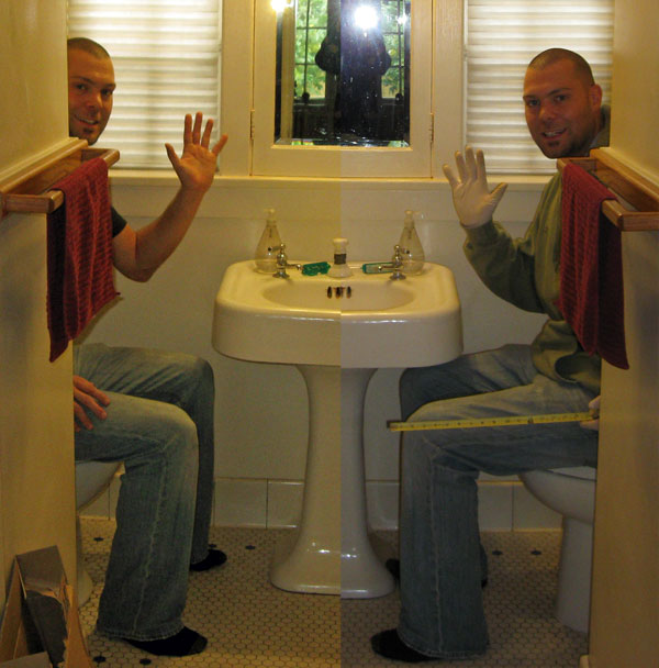

For the last several weeks I have been combing the internet looking for a toilet to replace my old 12" trap one. We live in an old building, have a 14" trap, and an old valve at a distance of 7.5" from the trap screws (middle of the trap) towards the wall. Besides, the bathroom door opens so that the toilet's maximum distance from the back wall is 33".
We would like to buy a good quality toilet that doesn't clog. Ideally, it would be ADA and one piece, and as narrow as possible. We are ready to pay up to $1000 or more, but the choices are very slim, we know we will have to compromise, but we dont want to compromise to much in quality.

If you are saying that the water shutoff is on the wall and at 7.5" to the left of center, then you have many options.
https://terrylove.com/wc/unifit.htm
The Unift adapter works with TOTO models

James demonstrating in an old Seattle home that has a 14" rough-in.
The 14" Toto on the left gives a lot more leg room then the 14" A/S Cadet on the right.
