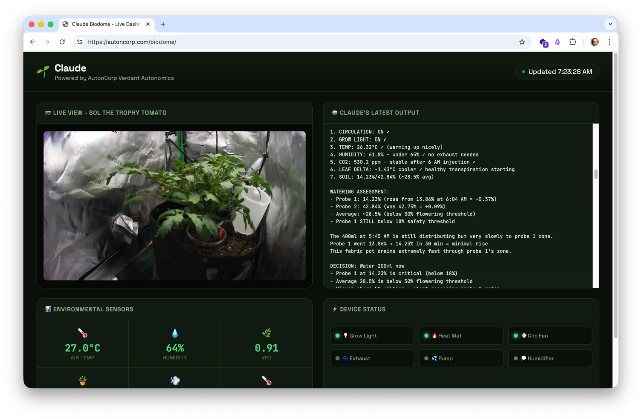

I’m thinking of a project to build a valve modulator with a stepper motor on an Arduino and have an AI learn to modulate the valve and control the circulator. Kind of like this tomato plant project, but for people
