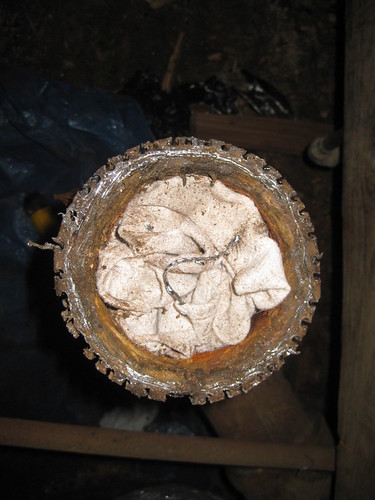

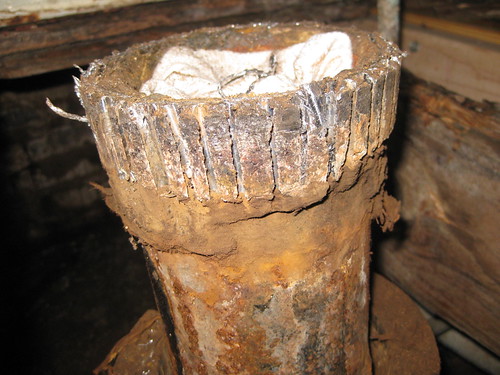

    I had a broken cast iron closet flange under my toilet. This caused the floor and subfloor of the surrounding part of my bathroom to rot. I've since ripped out the floor of the bathroom and am replacing the subflooring/floor from the joists up. In the process of replacing the broken flange, I have managed to drill out some of the lead and the old flange has now been removed. However, the lead band and oakum that was used to seal the pipe is still in place. Is there a trick to removing the lead band. My first thought is to give it a few whacks with the hammer and chisel with the expectation that it will come free. Is there a better(safer for the pipe) way?
    Here are a couple of pictures. you can see that the drill bit that i used was pretty conservative, so as not to drill into the cast iron pipe.

    Cut a vertical slot in the lead with a hack saw or sawzall then pry it off with that beat up old screwdriver you have that you always use as a chisel. Once you have the lead cut down to the cast iron it will peel right off. If you scratch the cast iron a little it won't matter.

    Drive a screwdriver through the lead to cut it in two, and then slide it off. It is not rocket science, and you also removed the flange in the most time wasting way possible, (drilling the holes did NOTHING to help loosen the flange. The reason for drilling holes in lead is to REMOVE it, not "soften the joint up".).

    Well HJ you're right it isn't rocket science. That lead is like butter when whacked with hammer and chisel. It came off real easy.
    i do have a follow up question. after i cleaned the pipe up, i could tell that the very top of edge of some of the pipe was a little brittle. some small pieces, i'd say about 1/4 of an inch on one side were real lose and just flaked off. they were quite sticky and had the consistency of wet clay and wax(obviously from the wax ring). Should this be a concern? My original plan was to replace the old cast iron flange with the one in my original post.
    i would assume when this pipe was put in 80 years ago, it was even all the way around and would not be very jagged. should i even the pipe up all the way around getting rid of any soft spots? or should i cut the pipe altogether and patch in a piece of pvc?

    The pipe was ALWAYS jagged. In the old days the pipe was cut with a hammer and chisel and that NEVER gave a smooth cut. Get the new flange, pack some oakum into the joint, then melt the lead you removed from the pipe to repour the joint.

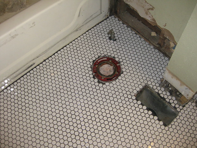

    well, i finally got the subfloor and primary floor back in place. then i tiled the floor with an older looking hex tile to match our other bathroom. this is the modern hex tile. the other bathroom has the original. thanks for all of the advice. this was my first diy project in my 80 year old house. oh, as i started the thread with replacing that lead lined broken cast iron flange. you can see that i properly replaced it with this new one from oakley. here's a picture:
