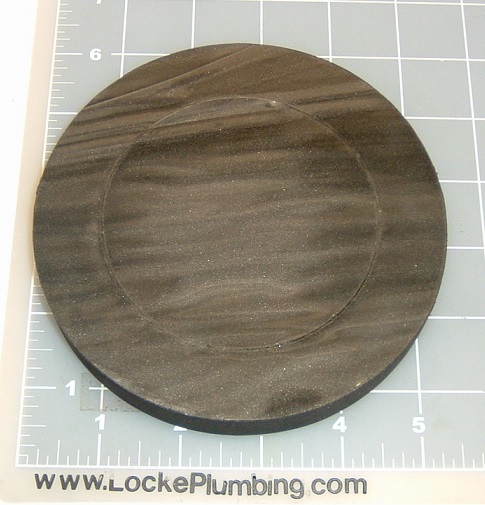

When a wax ring is unstalled under a toilet, how much is it compressed? How much is too much?

Since many of us do not use the ring with a funnel, we do not have to worry about it. The wax compression ranges from zero when the space it too wide, or infinite when the flange is too high and squeezes all the wax out. Almost anything between the two extremes is adequate. But the funnel introduces another variable because it takes up space and can cause the wax above and below it to be squeezed out if the gap is just adequate for the funnel's ring.

The wax fills the void space between the top of the flange, and the bottom of the toilet discharge area. If there is 1/2" space, and the wax is 3/4 thick, then that is what is squeezed.
Plain wax has been used for decades. Today, you can get wax which has a urethane donut embedded in it, for supposedly an even more reliable seal.

The funnel I was talking about is the funnel in the closet flange, not on the was seal.
My question is; I only have about 1/8" gap between the top of the closet flange and the bottom of the stool. Is that enough pace for the was ring to seal properly?

A little bit of wax is all you need. If a heavy person sets the toilet, it will squish down more than if a light person sets the toilet. The only problem with a thin wax seal is that, in the long run, it will squeeze out to nothing faster than a thicker seal. But that hopefully will take years.

Nothing lasts forever. My contention is that a 1/8" seal will not last as long as a 1/2" seal due to a combination of factors, including natural attrition of the wax. I've pulled many a toilet where the wax was completely worn or squished away.

1/2" of wax?
For the past few months i have been reading this forum and the John Bridges forum. The main point everyone stressed was that the flange MUST set on top of the finished floor. My flange was too low so i tore it out and installed a new one, setting on top of the tile. The flange is 7/16 thick, as all of themseem to be. The top of the flange is 7/16 above the tile.
Now it seems everyone has changed their minds and i should have set the flange lower somehow. The only way to set it lower is to set it on top of the cement slab instead of the tile. Thats the only way to get a 1/2" space for the wax ring.

Problem is there is 100 manufactures of closet flanges and each have different thickness. I have always set my flanges flush with the finished floor.

You're making this a lot harder than it has to be. The flange sits on top of the finished floor. You put a wax ring over the flange. You set the toilet. If the floor is uneven, you can shim it a bit and caulk it.
