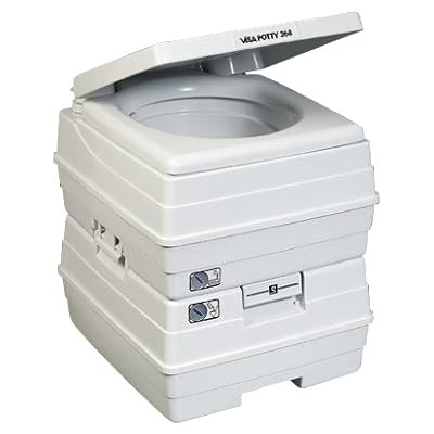

Our single bathroom was out of operation for one week, so I can sympathise. No toilet for this long presented us with problems. So we bought one of these:
We filled this in one week, so it was a very close call. Emptying it was thoroughly unpleasant, but it did not leak at all or smell (much).
