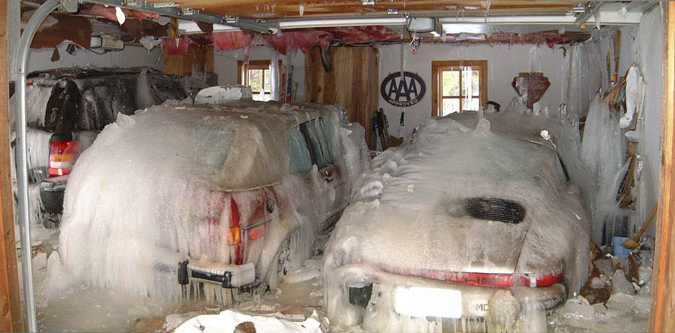

    [​IMG]
    Anyone want to guess how long this one took? :D

    Yeah, in my garage about 20 minutes.

    good thing he had triple A....

    A remote starter wouldn't be bad either...:D
