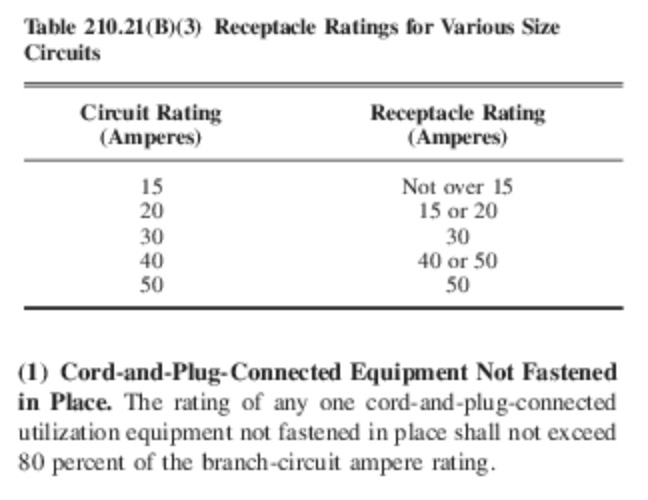

Says who?
Table 210.21(B)(3)

FWIW, I do own an EV and have an EVSE installed. On this particular brand, the instructions say if you hardwire it, a 40A circuit is fine, but if you put a plug on it, it must be a 50A circuit. But, the table from the code shown above says you can use either a 40A OR a 50A circuit with a 50A receptacle. But, not all installation instructions specify that. The code lists various types of equipment that can require you to go one way or the other, but does not say anything about an EVSE that I could find.

If you can't install a 20A receptacle on a 15A breaker, why do they allow a 50A one a 40A circuit? What am I missing, or what am I overlooking, if anything?
All you are missing is that the plug will not fit. That is done for good reason.
The ones that will fit are allowed. IE 15 and 20 amp. A 15 amp plug will fit a 20 receptacle, But a 20 will not plug into a 15.
You seem to be over thinking. Or maybe it is just me.
Good Luck.
Code allows a 50A receptacle on a 40A circuit. My 32A device, if wired to a plug and on a 40A circuit meets the 80% rule, and is okay, but it has a 50A plug attached (but not it's installation instructions, but that seems to be and exception for other brands).
Say I decide I need a 40A device, plug it in because it has the same plug, but now it no longer abides by the 80% rule, but probably won't trip the breaker. No inspection is required to just plug in a new device, but because the code allowed a 50A receptacle, wired and protected for 40A, it doesn't have the same safety margin. Some EVSE installation instructions call for the wiring to be 50A in this case, regardless, but not all.
My question is why is it allowed in the first place? If you are not allowed to put a 20A receptacle on a circuit wired for 15A, why is it okay to do the same thing for a 50A receptacle wired to a 40A circuit?

There are NO 40A plugs, but there are 15 and 20A ones. Code seems to allow a 50A plug to be installed on a 40A circuit, but they won't allow the same type of thing with 15/20A ones. Why?

NEMA 14-50R and 6-50R are used for both 50 amp and 40 amp circuits. There are no 40 AMP receptacles.
Majority of L2 EVSE devices draw max of 32 amp. As explained to me by my electrician, code allows a NEMA 6-50R(no neutral) or 14-50R to be installed with 40 amp wire and breaker. If wired for 40 amp (#8 wire) the breaker needs to be 40 amp.
Don't know why, but I would also like to know the reasoning.
When installing a new device, you have to do two things: follow the manufacturer's instructions and follow the codes involved. The particular EVSE that I have specifically calls for a full 50A circuit (wiring and receptacle) when installing one of their 32A devices when supplied with a plug. They specify a 40A breaker and wiring for the same thing hardwired. To me, that makes perfect sense, since if you installed a 40A device on that 40A service, it may not trip, but would not provide the required 125% capacity (80% rule) for a continuous use device like that. FWIW, EVSE = Electric Vehicle Support Equipment (essentially, a smart on/off switch, the charging circuit is in the vehicle). On some EV forums, I've (apparently incorrectly) been pushing to make the circuit 50A to match the receptacle, and the device I have requires that in their instructions, but after I started this thread, I looked at a few more, and some either don't say, or allow it to be a 40A circuit with that 50A receptacle. As I said before, they don't allow that for a 15A circuit, you can't put a 20A receptacle on it, but you can put a 15A one, because the device hooked up to it won't stress the wiring. That is NOT true of a 50A receptacle on a 40A circuit...many people would just see that the thing they want to plug in will fit, and use it.
It is known as load diversity same reason we are allowed to take only forth percent of our service load for anything over ten KW.
