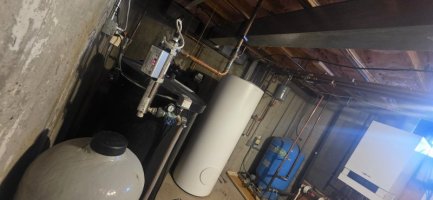

Hi all,
I was looking for help with my signature 2000, pressure tank. When the pressure hits 60, the needle takes a big jump and makes a noticeable shake/noise and goes to 58. I pulled the plug drained everything to check the pressure which did read zero. I pumped it back up to 38 psi, and it appeared to hold. Unfortunately it didn't make much of a difference. Here's a video of what's happening

The bounce of the pressure gauge suggests a water hammer issue. Water hammer is often the result of the use of too many check valves in the system. Suggest posting a more complete photo of your system which will clearly show the complete water path, including placement of any check valve(s) and other devices.
The placement of the pressure switch is also not conventional as the PS is normally located as close as possible to the tank connection.

Thanks so much for the reply. I'll drain again and check the pressure to see if it holds. I'm ok with replacing the whole tank as long as that's the issue and i'm not just throwing money away :) The well tank is in blue, flows to my water filtration system, then needs to get repressurized again after the aeration tank and goes out to my indirect water heater, my boiler (pointed to in red by arrow), and to my fixtures.

Thanks for the reply. It does turn on around 40 goes to 60, then makes an aggressive sound, the needle jumps and stops at 58. I honestly don't know about a dome limiter? i posted a couple more pictures of my setup below. All pressure should be around 40-50, but i can confirm.

Thanks for taking the time to reply, based on my setup where would I put the CSV?

What is that pictured system doing? It looks like you have a pressure tank and pressure switch over in the corner, and I suspect that one is fed from the well.
Or is the well feeding the system closer to the camera?
mikeee321
23
Massachusetts
Sorry for the confusion, the pictures are posted as follow ups, the issue is in the video. When my tank hits around 60 psi, there's a jump in the gauge and there's a sort of a bang. Trying to determine if its my tank or something else.
42,183
5,206
Confusion remains.
What is that pictured system doing? What is that system in the corner doing?
Is that pictured pressure switch teed into the big black thing behind it.?
Pressure switches belong at pressure tanks.

Think there's a valve chattering. Is there a solenoid valve that I'm not seeing? Ex tank wouldn't make a gauge jump like that.

Apologies. In the corner is my well tank it feeds into my water filtration system, water softener, ph neutralizer then to an aeration tank (big black thing). It then needs to be pressurized again by a signature 2000 unit which is the focus of the video

Your pressure switch is too far from the pressure tank. Thats why the hammer is so severe. Moving it as close as you can to the tank will alleviate it, but probably not eliminate it.
Listen to Valveman if you want to get rid of it, and the big repair bills that will soon come if you don’t.
