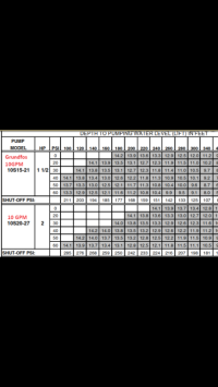

Just had a new well drilled and we're in process if figuring out the new pump system.
The well specs are:
645' deep
300' static water level (driller dropped a stone down and counted it out, 3sec so apparently it's 300'. Is this standard practice? I'll be measuring this with a a washer and string to verify)
Metal Casing 6"
50gpm at 645'
Called a couple of well installers around the area. The 3 that quoted (out of the 5 we contacted) all 3 came back with a 1.5hp pump, 400' 1" pvc, 52gal (one said a 44gal) pressure tank. 1" PEX going from the pitless adapter to the pressure tank inside the house.
In my findings online, this seems like 1/2 the amount of power that is needed for this deep of a well, am I wrong?
From what I've researched, my calculations are as follows:
static water level 300'
pressure tank 139' (60psi) (using a 40/60 switch)
horizontal run from pitless adapter to inside the house to pressure tank 115'/10 for friction = 11.5'
Total Head = 450.5 (correct?)
So with 450.5 Total Head, I should be running a 3hp pump.
And if I'm doing this myself, I would run 1.25" poly pipe roll sidr7 rated at 250psi down the well 450'. Then 115' horizontal from the pitless adapter to the pressure tank inside the house. I already have a 3" pvc sleeve ran for this.
Other notes:
- use 8g wire
- only use 1 check valve (the one that comes inside the pump)
- use a torque arrestor about a foot above the pump
- poly safety rope
- Pressure Tank 119gal.
I'm still looking for the best quality pump brands and starter box.
What do you all think?
I just can't seem to understand how the 1.5hp pump would function with a 4 bath home which I estimate at 15gpm usage would work?
Thanks again all for the help!
