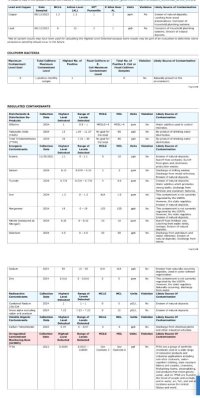

City water report looks pretty good (included), EWG states there are 12 contaminants that are high to their standards and 10 can be filtered out by carbon alone. We would like to avoid a RO system, so I already bought this under sink filtration system for drinking water: https://www.ewswater.com/product-page/essential-drinking-water-system
