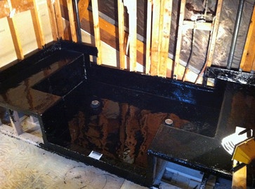

  16. johnfrwhipple
    johnfrwhipple BATHROOM DESIGN & BUILD for both Canada & the US
    Joined:
    Jul 20, 2009
    Occupation:
    Design Work World Wide: Bathrooms Vancouver Area
    Location:
    North Vancouver, BC
    Using Hot Mop & Kerdi or Hot Mop & NobleSeal TS
    I have two clients right now building showers in California. Both are using Hot Mop. The way your build is outlined you do not have a proper installation. Look through the link below to see some of the steps needed to succesfully hot mop your shower.
    With the two builds I/m involved in one is getting Noble Seal TS and the other is getting Kerdi DS. These products for the walls and ceilings but the floor, and curbs will get a traditional hot mop.
    What do you think is safer? - insisting that a new crew use your shower for the first time to install new products or go with a time proven system like a hot mop?
    Here is some info on Hot Mopping that might be helpful for some.
    http://www.houzz.com/ideabooks/8715503/thumbs/California-Hot-Mop---Waterproofing-your-shower
    ACO has a new clamping drain just for California Hot Mop's.
    [​IMG]
    HOT MOP can and does work well in shower construction. Look at this shower with two drains - very hard to build that with a liner or sheet membrane.
