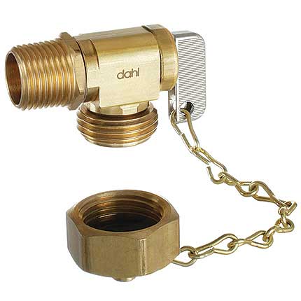

In the picture, I want to add a drain to the circled pipe, which is capped, using a valve of some sort. Any recommendations? I looked for an end cap with drain but they don’t exist in quantities less than 50. And I don’t think the Nibco ones are potable water rated.

See Dahl 221DH-01-04-CC
You can solder that onto 1/2 inch copper pipe.

In my area, Home Depot sells the low lead boiler drains and caps separately. I suspect most of the big box stores would be the same.
Adding a drain to the capped line doesn't drain the hosebib when that line is shut off. And if you add a drain there and open it, then you can't use the water heater.

Since that is the only pipe below the hose bib piping other than the hot water heater, I wanted to add a valve to that stub pipe to drain the hose bib pipe in colder months or if work need done on it be able to drain it. I would shut the water heater valve, shut off house water, open hose bib pipe, then open this stub pipe valve along with others to equalize pressure. Once drained reverse order turning things back on or off. The stub pipe used to be a pressure relief valve before the expansion tank was put in.

In any case sharkbite makes hose bibs, you could remove that cap and push the bib on if you want to go through with this. It'd be just as simple to undo if it doesn't work out.

Maybe I'm missing something, but it doesn't seem hard.
My though is to cut in a tee between the spigot and the shutoff to add a valve like the one Reach4 suggested on the branch via a short piece of pipe. To drain the faucet, shut off the supply, open the spigot and then open your new valve. Depending on whether the spigot is above or below, water will come out or air will go in. If it's water out, attach a piece of hose to send it to a drain or a bucket.
That should work, though I don't know if it violates code to let the water drain backward in the line.
