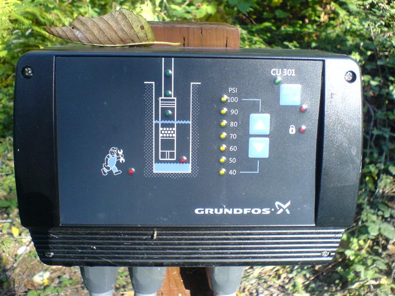

Grundfos CU 301 installed outdoors w/ no cover.
Singlecoil
I just went to a housewarming party at a friends house and checked out his well setup. I installed my own constant pressure controller and pressure tank, so I'm somewhat familiar with those systems. Mine is a different brand, but I was very surprised to see the controller (the computer) installed outdoors on a 4x4. It seems to me that it should be indoors rather than out exposed to the weather. I looked at the grundfos website, and their literature is pretty poor, but this looked pretty odd to me.
There was a big green tank lid next to the well as well, so my guess is that chamber contains the small pressure tank and the pressure sensor. It all looked pretty bizarre to me.
Should I tell my friend to call his builder?
I have a closeup of the controller, but I wish I had taken a photo of the whole setup.

I think we covered this earlier. It doesn't matter which brand it is. Those variable speed controllers are computers. They are just as susceptible to heat, cold, dust, moisture, insects, and electrical problems, as the computer you are using to write this. Would you set your PC out on a pole in the elements? Then you should be just as careful with variable speed drive computers.
Even if you put the controller in the den with your PC, you are still going to have problems with it.
However, here is a recent link on how to solve the problems with this type system.
https://terrylove.com/forums/showthread.php?t=23931

I was looking for a definitive response from someone who installs these systems so I could send my friend a link to this thread. I posted on here because this site seems to have more traffic. I couldn't find anything in the documentation I found online that says you absolutely can't put it outdoors.

It was hard to find but, here is a link.
http://www.us.grundfos.com/web/download.nsf/Pages/A69314CD588FA7BC88256CBF0067EDB8/$File/L-SP-TL-019.pdf
Number 8 says, -22F to 113F degress, must not be in direct sunlight, and maximum humidity is 95%. Didn't see anything on enclosure ratings. The spiders and bugs I find in them probably doesn't help either.
