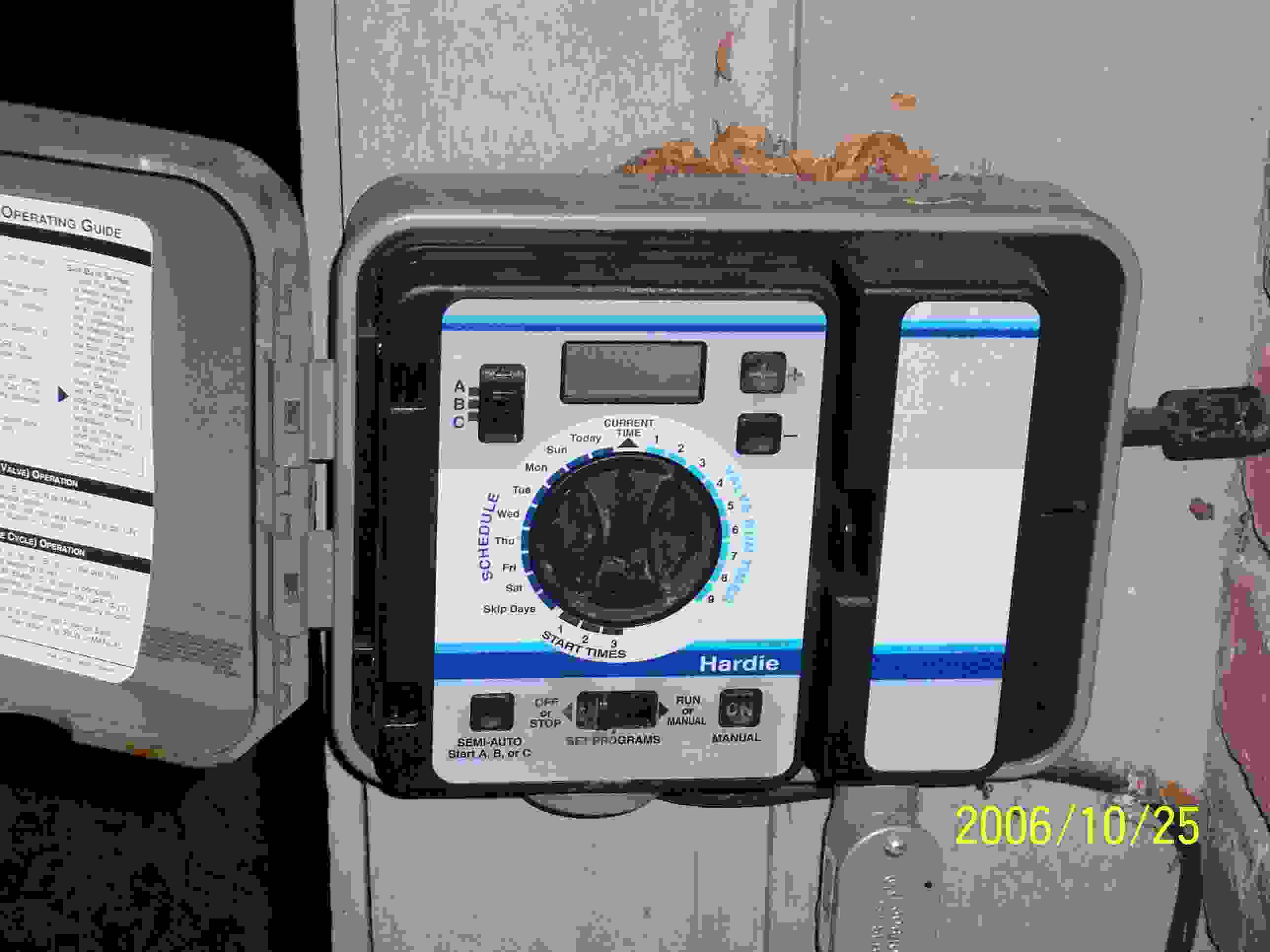

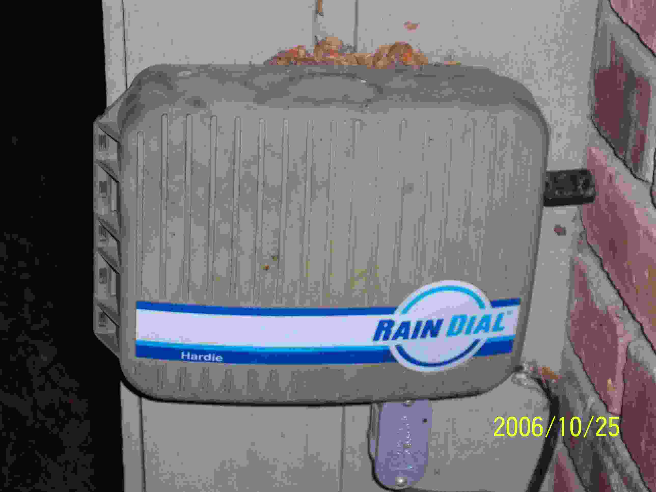

    I've found a box (see pictures) [​IMG][​IMG]that I think is the electronics for the valves.

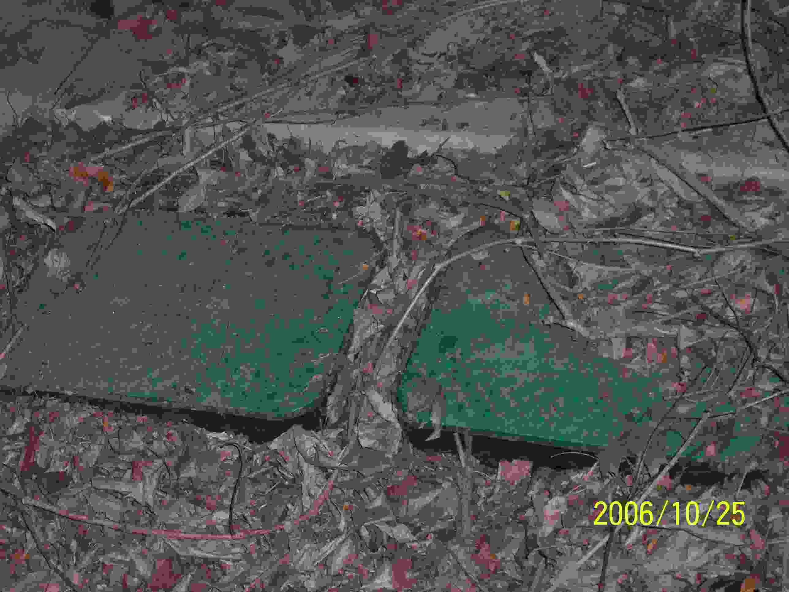

    I also have these two green boxes [​IMG]that appear to be buried in the ground. My general rule is don't mess with things that you don't understand ... so what should I expect (other than dead animals) in these green boxes?

    You'll find the 24 VDC electric valves in those boxes. All in all your system looks operational, I would just manually turn the valves on and see what works, you can either do that at the valve, or from the control box on the wall.

    Make a quick trip to a box store and take a look at the various components. Having no experience with drip irrigation, I can't say for sure about draining the lines in the winter, but I'd be a bit concerned about water in my lines. Backflow preventers are connected with unions in my system so it can be easily removed and replaced. A manifold is something you manufacture to accomodate your valves. The main water line comes in and is divided with tees into the individual zone valves, each of which has a line coming out. The valves will usually be in a line and live an a control box. Mine are under the surface of the ground, but they wouldn't have to be. The control box for the valves can be located most anywhere, it is just a timer device that sends low voltage power to the solonids on the valves at and for the prescribed time. I plugs into a standard AC outlet and has a 9VDC battery to keep the programs if the AC fails. (Not to operate the system) Mine is in the basement just inside of the valve box location. The wires go through a conduit which is sealed against water leak. There is a hot wire for each zone in the system plus a single ground common to all zones. I can't speak for your city, but I'd be surprised if they don't require preventors and inspections. If I don't comply with the inspection, my water service is terminated. At least in theory, a system that had no backflow prevention could contaminate the city water main.

    Acutally the 9 VDC battery runs the program all the time, the AC transformer supplies the 24 VAC to operate the valves.

    So my next question is: How do I open those boxes. I haven't tried yet.
    There's a depression on the cover that looks like I could get a pinky in there. Do I use a screwdriver? If I open it will I be breaking a watertight seal?

    They are valve boxes, go to the orange box store and look in the plumbing department. I use a screw driver between the green lid and the black box on the end where there is a depression and hole, it is not watertight, and definately not gopher proof.
