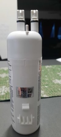

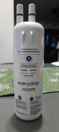

this is the filter. now i just took it out and sucked a bit of water thru the ports and the one on the right side has the bad taste and the left one is ok looking at the right photo and the pin between the ports. so that taste must be coming from something between the water valve in the wall and that port. i do not know if this is a carbon filter or just a woven one. but my guess is a carbon filter being it it may be the plastic tubing connecting the fridge. the store installed it so maybe they use a plastic line that puts the taste in there so they can sell filters.
Amazon has a filter for $15 that is a knock off has good ratings. Filter material is a carbon block. Take mirror and flash lite inspect the water spout see if it's clean.

i do not think the port is dirty as you can see the filter ports in the photo. i'm leaning on either the line from the wall shutoff to the fridge is the wrong line and adding the taste or there is something in that area the filter plugs into that puts the taste in so that you just get filter because you think that is the reason the water is bad tasting. the water line to the fridge is a tee fitting next to the kitchen sink that i had to put in because the plumbers forgot and left. thanks
