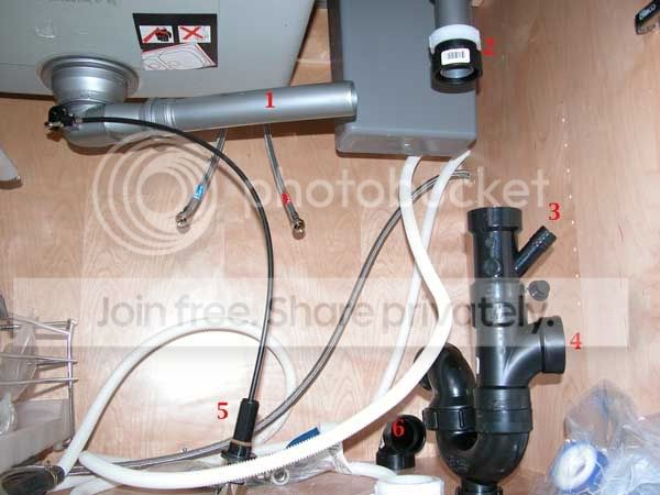

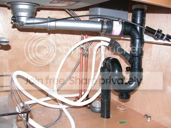

#1 - 40mm drain pipe coming from the large sink
#2 - 38mm drain pipe coming from the collander - fits fine with normal compression fitting and 1.5" ABS
#3 - dishwasher will drain here... double drawer KA thus the two white coils
#4 - turned opposite... where #1 drain pipe will connect to
#5 - plunger that operates the drain plug for large sink
#6 - 90º ABS to basement and line that includes vent stack
all installed on island.. I still have to figure out a way of getting through the tile below the island... but that's another story!

so this is what I have come up with but have been advised that it may not pass code due to "S" in ABS???... what does this mean?... below floor level is a double ABS line that the downdrain ABS hooks up with, one line of which goes to the vent stack
29,946
3,460
I been advised that it may not pass code due to "S" in ABS???...
No worries. You live a long ways from me.
It will only smell in your kitchen, not mine.
Because the trap is not vented, when the water drains, it will siphon the trap dry, then your wife will start complaining about the sewer smells while she's cooking dinner.
A fix for that would be to add an AAV on top of a santee, the top for the vent, and the side of the tee for the p-trap.
This is how most plumbers would have plumbed your sink
The drain going down should have been 2" and have a clean out.
Yours is 1-1/2", which hasn't been code since the 50's
You're about 60 years late on your piping.
You also haven't high looped or air gaped your dishwasher.

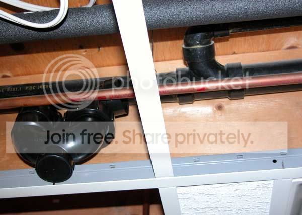

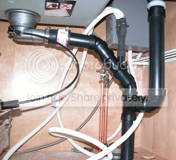

with this project we actually brought in a "real" plumber to start the job as we were taking down a bearing wall that encased the waste vent stack... and this is what he came up with...
this is just below the island and my intent was to hook up what I had in my previous picture to this assembly thinking that it would provide me with the necessary air to get the water flushing down the system... is there any way I can then work with this?... can I run everything down below the studs and try and create a P trap below the floor and hook it up to the config shown here?

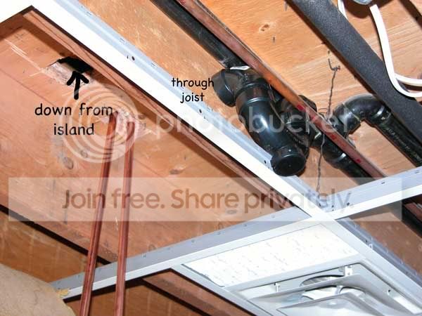

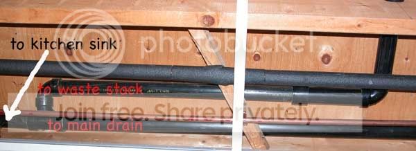

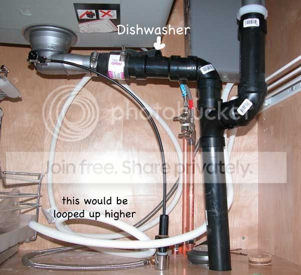

ok ... so this is the new "dry" setup showing picts of island as well as the drain and vent pipes below the island
pict 1 - under cabinet... with DW hooked up on the horizontal run and white drainage hoses would be in large loop on back wall to ensure flow
pict 2 - from island plumbing to Ptrap... hole (black arrow) shows where line from island plumbing would come down, make a 90º, go through joist, and make a 90º into the Ptrap which would hook up with the line (within 10") of where it diverts to the drainage line and the vent stack
pict 3 - a larger view of the Ptrap to main ABS line in place right now
is this an ok setup or do I need additional changes?
is the angle (can't be vertical due to close proximity of the drain line from left sink to sink bottom) of the DW ABS ok... it will probably be about a 70º angle once in place with this setup unless I move it closer to the main vertical line

I don't think most codes allow the P-trap under the floor but I see it all the time. Is that a horizontal vent under the flood rim? Could be a no-no too.

You can put a p-trap under a floor no problem. If it's not readily accessible it must be a glued trap not a union trap.
If you couldn't put traps in floors how could you ever put a trap on a shower or a bath tub :D

its readily accessible... suspended ceiling... I am also looking at this as a setup which (to me anyway) would allow me to get the water heading down quicker on the much larger left sink as well as allow more room for the DW SanWye... I will be doing a large high loop of the white DW drain pipe as well...
another question... is it better to put the Ptrap directly below the down drain and then 90º to the right, through the joist and another 90º left to the vent/drain assembly, or as I show it in the picture previously posted?

By placing the trap under the floor you are exceeding the allowed distance between the trap and it's fixture.
John
29,946
3,460
And that's why nobody does under the floor traps for kitchen sinks.
The tall tailpiece allows the trap to siphon.
You still have it run in 1-1/2" pipe.
The lower part should have been run in 2"
You have also used a santee below the floor where a wye fitting should have been used.
If you wanted to AAV it, I would have run a 2" waste line over using waste fittings, that means wyes and long turn 90's

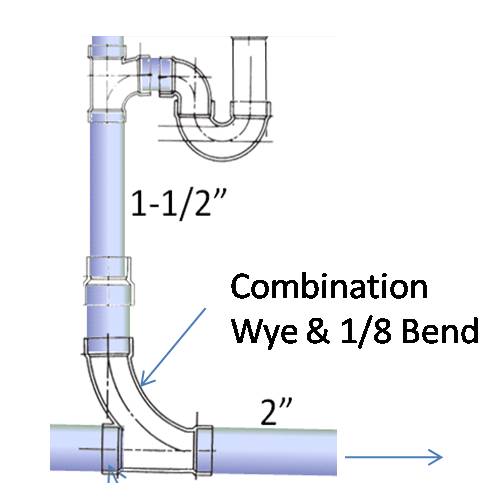

If you wanted to Island Vent it, it would look like the picture below.
This drawing below would work if an AAV was above the santee and the santee was 2"x1-1/2" x 1-1/2"
The verical below the tee would all be 2"
