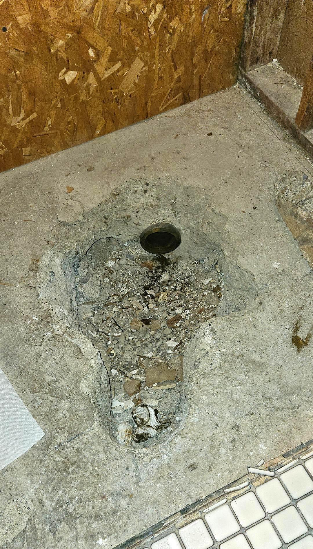

My house was built in 1950, ranch on a slab. A previous owner installed a fiberglass shower in the late 60's early 70's (based on the flower wallpaper and gold flecked tile I found behind the surround. I've owned the house for 25 years.

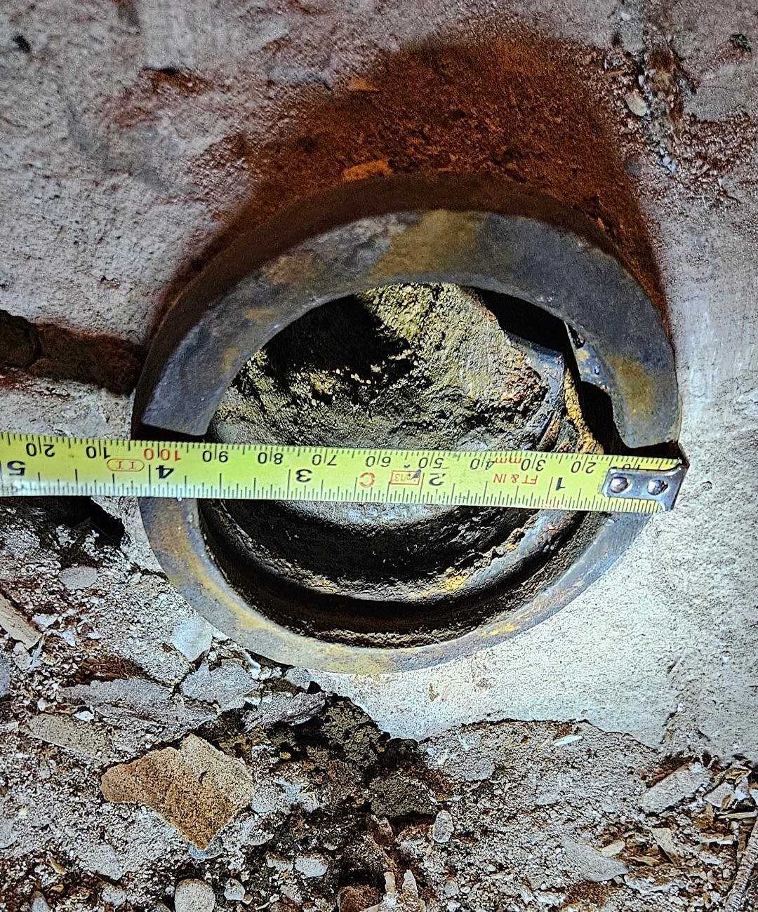

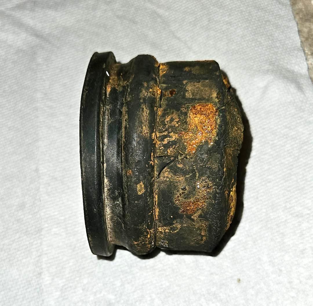

When I removed the old shower base I discovered that the 2" PVC pipe was loosely inserted into a rubber gasket inside a cast iron pipe and had some kind of caulk smeared around the outside of the joint. I assumed (incorrectly) that I could go to any home improvement store and buy a new doughut and get on with installing a new shower.
The inside of the pipe flange is 3-1/4" and the outside is 4-1/8". Fernco 2x2 doughnuts are 3" OD.

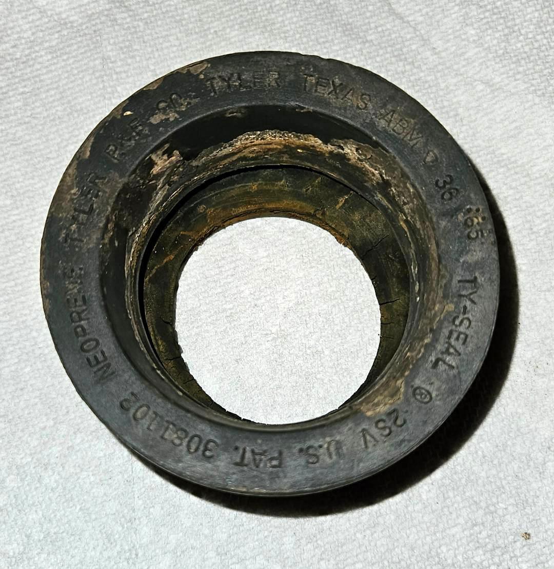

I took the old rubber gasket to a nearby plumbing supply house to see if they had a replacement. Nobody under 55 had a clue what it was. They finally asked a guy about my age and he said "I haven't seen one of those in ages". He said the cast iron pipe was "extra heavy/oversized, nothing like we use today" but he googled the gasket and found one on the Porter Pipe website. They show out-of-stock.

Well it looks to me like you can easily find the ty-seal service weight gaskets online. Based on the labeling, it appears you want 2 inch service weight. Hard to imagine it would be a better idea to make a lead hub joint, but if you really do want to go this way, you could consider using Soil-o, which is a lead substitute product for making such joints that is safer than working with hot toxic lead.

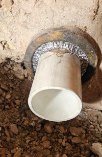

According to the local supply house, my pipe is "extra heavy (oversized)" and the only company that shows the necessary fitting shows it perpetually out of stock. I ended up making a PVC stub piece with a lip to keep it from pulling out and used oakum and lead to hold it in place. I couldn't find any supply houses (local or online) that would sell me a lead joint runner (rope) without a plumbers license so I used 3/4" oven gasket and a binder clip to hold it in place. I made a tool to press the oakum into the joint out of some scrap steel. I peened the joint after it cooled. I work with lead often for stained glass window restorations, I just wasn't aware it was compatible with PVC for plumbing. Hopefully this is my last time doing this.
