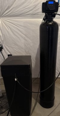

I recently lost power and noticed my system started doing a regen every night. It was flashing between the time and RC_ _ _ _.
I did a hard reset and now everything is back to the factory predetermined settings. I know how to get into the system settings, but I’m unsure as to how the calculations are determined, for my specific setup.
Fleck 5600SXT
48000 grain
8% high capacity resin
Well water (my water is crystal clear and has no smell)
Hardness of 17 (tested by a local water company)
Iron of 0
4 household members (two adults, two children)
I live in NE Ohio.
Looking to get a good blend of "soft" and efficient on salt usage. I have been reading through various posts on here for a situation close to mine, but I just want to make sure it’s correct for my specific setup. If there’s any other info that’s needed about my system, please let me know. I posted pictures of it. Any help would be greatly appreciated.

System info (not programmed)
salt lb/cuft​
8​
A choice ( efficiency vs capacity)​
BLFC​
0.5​
Brine Refill rate GPM​
cubic ft resin​
1.5​
ft3 resin = (nominal grains)/32,000​
Compensated hardness​
19​
high-hardness compensation added.
People​
4​
gallons affects reserve calc​
Estimated gal/day​
240​
60 gal per person typical calc​
Estimated days/regen​
7.89​
Computed days including reserve​
Fleck 5600SXT Settings:
DF​
Gal​
Units​
VT​
dF1b​
Downflw/, Single Backwash, black cam​
CT​
Fd​
Meter Delayed regen trigger​
NT​
1​
Number of tanks​
C​
36.0​
capacity in 1000 grains​
H​
19​
Hardness-- high-hardness compensation added.​
RS​
rc​
rc says use gallons vs percent​
RC​
240​
Reserve capacity gallons​
DO​
30​
Day Override (28 to 30 if no iron)​
RT​
2:00​
Regen time (default 2 AM)​
BW​
5​
Backwash (minutes)​
Bd​
60​
Brine draw minutes​
RR​
5​
Rapid Rinse minutes​
BF​
8​
Brine fill minutes​
FM​
____0.7​
