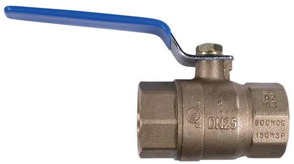

Hi speedbump,
Can you explain to me what valve I should be getting? Is the picture below is what I should be getting? And do I connect a faucet to this valve so I can conduct testing?
What about the gauge? Is the connection suppose to be like this(from left to right)
my 1" pipe -> T -> valve -> gauge -> pipe going to whatever

It would be 1" pipe, tee, gauge valve then add some pipe temporarilly of the same size or bigger to where ever your going to do the bucket test. You will want to run the water with the valve closed enough to see 40 psi on a (new gauge), then see how long it takes to fill the 5 gal bucket. This is the amount of water your sprinklers will have available if your city water is constant.
