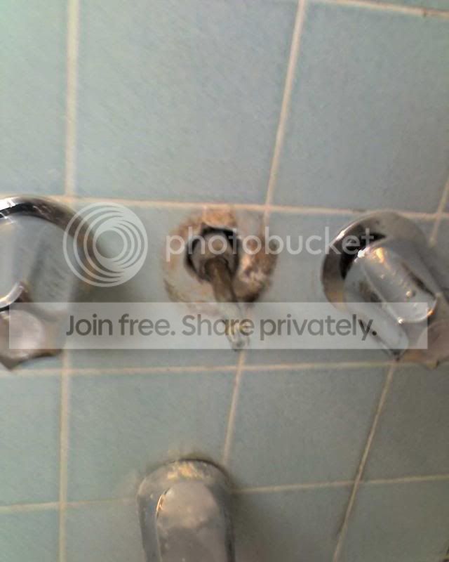

    I've replaced the faucet stems on the hot and cold faucets on my bath tub, using the shower valve socket wrench. However when I try to remove the diverter stem, the stem unscrews to the point where the stem is all wobbly like it should come out, but no matter how many times I rotate the stem it will not come out.
    It's like rotating a bolt counter clockwise forever that never comes out.
    It will retighten and function properly. (Its present state. I've turned the water back on and there are no leaks).
    Incidentally, I used a handle puller to pull off the handles which were stuck on. Could I have harmed the threads which is causing this? My feeling is it's a thread problem.
    The junction is recessed in the wall so there is no access. I've tried rotating the stem with the valve in open and closed positions.
    Any suggestions on how to remove this stem?

    We would like a picture of where you're at.
    Two things come to mind:
    > diverter stems have a back-seat washer, and those sometime get splayed out and can be tight. Usually just needs a lot of wiggle.
    > if the wall is tiled, and the tile guy was "too cute" there may not be a hole large enough in the tile for the largest diameter of the stem to come through. If that is the case, you can "worry" the hole out carefully with a small cold chisel.

    I've tried shaking it. The hole is clear. Sorry for the ugly photo.
    Maybe I should add that I used a dremel to grind away tile along the hole's circumference so that there would be the necessary clearance to get the socket in. I did this on the other faucets with no problem. I don't think I could have damaged anything.

    Please don't breach the wall. YOU CAN FIX THIS. Price Pfister Verve.
    Can't tell for sure from your pic. Did you remove just the small outermost nut....the stem packing?? You need to turn the whole body, the part that you need the socket to go into the wall a little, although yours may be out far enought to put channel locks on it.
    If you are in fact turning the main body, (a) make sure to put the fully counter clockwise ( as if using SHOWER). (b) either it is not clearing the tile, which is close, or it just needs more wiggle.

    Although the stem wrench is the same size, the "business" end of the diverter stem is just slightly larger than the hot and cold, so they can not be interchanged. With a flashlight, you should be able to see what is hanging up. I still think the tile is too close. There are no other threads in there. Try turning the handle all the way tight to CCW ( shower ) position to lock up the back washer.
    The problem might also be this: the back seat washer is a ridid nylon washer. The sometime break in half. You could have a piece of that getting in the way. No downside to pulling harder!
    And. YES, you can work on the diverter without turning off the main water.

    Thanks for all the replies and help.
    I pulled harder and it came out. I guess there was some obstruction that I didn't notice.

    Incidentally, there was a broken washer in the recess above the seat. Maybe that contributed or caused the impedence. I don't know.
