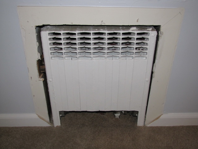

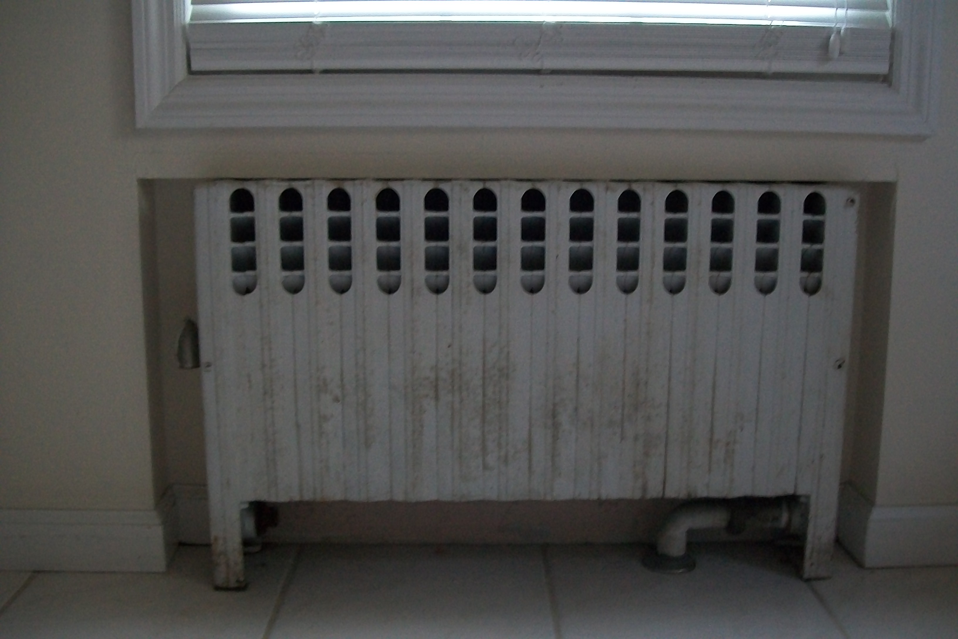

The volume of cast iron baseboards isn't large, not dramatically more than cheap fin-tube, but some. If by "wall radiators" you mean something like an Arco SunRad or
Burnham Radiant installed inset into a wall, they run about 0.15 gallons for every 2.25" (the width of an individual section.) Using standard
plumbing volume tables, try to get a reasonably good estimate the total water volume of the system before up-sizing the tank. I suspect upsizing it not really needed here.
< Arco SunRad
Burnham radiant
With the water volume and the water temperatures and pressures you can use
Amtrol's handy web calculator to see if you're close to the margin for a 30 psi pressure relief valve with the existing expansion tank.
