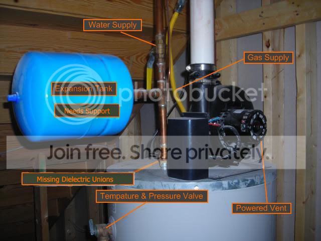

I pray you are not a plumber in the state of Illinois. Here is the part in the Illinois plumbing code about how and where to install the expansion tank.
A properly sized and approved expansion tank shall be located on the outlet side of the check valve, PRV or backflow preventer, in the water heater's cold water supply with no shut-off valve between the heater and expansion tank.​

Since there is not be a shut off valve installed between the expansion tank the the water heater, we normaly do plumb a Tee in at the top of the water heater and install the expansion tank on one side of the tee, then the water supply with shut off on the other.
