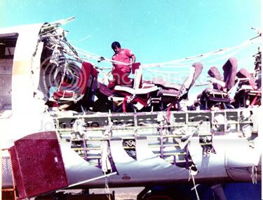

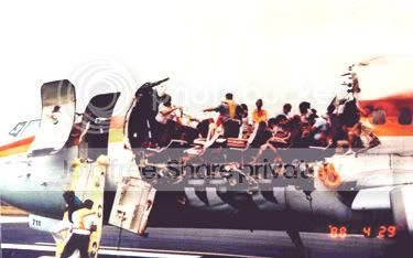

    Installing one could increase the service life of your water heater.
    The extra 40 PSI isn't enough to cause the T&P to release water but in a pressure vessel there is a certain number of expansion cycles that it can take before it tells you replace me!
    This is a picture of a failed pressure vessel that had to many expansion cycles on it.
    [​IMG] [​IMG]
    Aloha Airlines Flight 243
    Keep flexing that water heater tank and say Aloha Baby!

    It shouldn't affect the water heater one way or the other. What could be affected is the washing machine hoses and the small supply lines to your faucets.

    Ahh.....but it does.
    Water heaters these days are built with such a thinwall spec that expansion and contraction of that tank scribes tiny microscopic hairline cracks in the walls of the tank. Those cracks will sometimes leak, cancer out and seal off. Sometimes there's a bunch of them on a water heater and then one "bigger" one decides to let go and never seal back up. Consider it like a set of lungs that grow and shrink.
    Metal has flex tendency but given the nature of aggressive water, glass lining so thin and a anode rod that's life is gauged long enough to get past warranty, it's a sure fire bet that large pressure spikes can affect the tank along with what you mentioned.
    Job security for us all which is great, but the tanks built today are so vulnerable by just their design that it's sickening to know people will be replacing their heater numerous times in a 30 year period of living at the same home.
    This wasn't like this back in the 60's, 70's.
    In today's market, a tank lasting 20 years? The mfg. would look dumbfounded and say,
    "What in the hell did we do wrong here?!"
