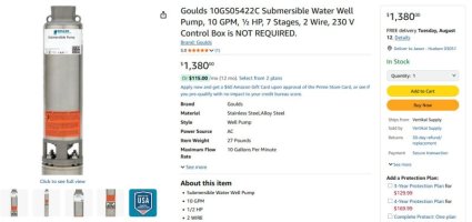

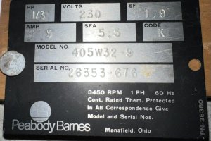

It originally had a Peabody Barnes 1/3HP 230Volt 1PH 5 Amp Pump and a 20 Gallon Well-X-Trol Pressure tank.
Back in 2018, I woke up one morning without water.
A nice gentleman from a well pump company came over, investigated and told me I needed a new pump.
At the time I didnt have the $4,500 he wanted to replace the pump so I thanked him, paid the service fee and he went on his way.
A buddy and I changed the pump to a 1/2hp 230 Volt 10GPM 2 wire Goulds Pump and installed a new Well-X-Trol WX-251 62 gallon pressure tank.
At the time, I was unable to locate a 1/3HP 230 Volt 2 Wire pump thus I installed the 1/2HP pump.

It appears the pump is tired/injured and will need to be replaced? If I replace it, which size should I install?

It doesn't matter that the well is 120' deep, it matter how deep it is to water. If the water level is higher than 60' the pump you have is ok. But if it pulls down more than 60'-70' you need a 10GS07 instead. That pump cannot build to 60 and shut off if the water level is deeper than about 70'. That maybe a big part of your problem. When a pump cannot build enough pressure to shut off and runs all the time, the electric bill is high and the pump wears down and is able to build even less pressure.

How was the 1/2 HP 10 gpm pump for the first 3/4 of its life? If you go to 3/4 HP, you will need to check that the wires and breaker are big enough.
A 1/2 HP 7GPM pump would give more pressure if your pressure needs are higher, and would probably supply enough water. You might have to adjust the emitters on your irrigation to a lower GPM. A 7 GPM pump would cost more -- it has more stages. Ten gpm pumps are usually the cheapest to buy.
