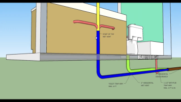

This already has existing waste and vent pipes installed (they haven’t poked through roof just yet thankfully), however as in an earlier thread they are most likely wrong. It contains two horizontal vents under the floor. I will also post a drawing to the best of my ability how they are currently laid out. I’m willing to fix before moving forward with my project.
I would prefer to vent only on the right wall, second option would be only the left wall, third and the “if necessary” option would be venting pipe going up both left and right walls. My concern basically is limiting roofing penetrations, but not opposed to 2 penetrations here if needed. Routing one of the vent pipes in the rafters MAY be an option but it’s a vaulted ceiling (no attic) so it’d have to be bored through the 2x6 roof rafters.
The 4x6 beam may be a problem. It is a lot easier to get around or to notch the bottom of it further down the room closer to the bottom/south wall...toward the main line/concrete footer. As a way to explain the height of the 4x6, it is under 2x6 joists, and parallel and at the same elevation as the 3” toilet drain line up until the concrete footer, which is where that same drain line drops fully below - in elevation - the beam. The 3” toilet drain may be able to be moved to the left side of the beam after checking my slope and amount of room down there)
Sorry for my iffy measurements in places (4’ or 5’) I don’t know EXACTLY (given p-trap, etc.) where the measurement needs to be taken from...
EDIT: 3” toilet drain can probably be routed onto the left side of the beam immediately after toilet flange

I think I see two options...
1) move 3” toilet drain to the other side of the beam so the tub can tie in to it in a shorter distance, as well as the shower, and have those wet vented in the toilets line. Have toilet vent, and tie into vanity vent and go up and out the roof.
2) leave it as is, vent up both left and right walls. Toilet and vanity tie together above flr, and shower, tub tie together above flr which would be two 2” vents poking through roof.
Both methods will include cutting out dry horizontal vents.
Do both of these work? One better than the other? Or another recommendation?

The lav absolutely requires a dry vent in the right hand wall. A variant on option (2) would be simplest: make the lav a 2" drain and vent, use it to wet vent the WC, put a dry vent on the tub that rises into the left hand wall without going horizontal below the floor, and use it to wet vent the shower.
But if you absolutely want to avoid vents in both walls, you can do something like the diagram below. Red is 3", Blue is 2", Green is 1-1/2". [Edit: none of the drains are 1-1/2", that was an error and I updated the diagram. The lav dry vent can be 1-1/2".] The idea here is that the lavatory can wet vent the tub and the shower by crossing over the beam through a joist bay. If the shower and tub drains are below the joists, it's probably best for the lav drain to cross over the beam fairly low and then just gradually drop below the joists to join the tub drain.
The lav then wet vents the tub; with a 2" trap on the tub, the tub trap arm can be up to 60" in length, so that the maximum allowable run from the tub trap to the wye where it joins the lav (along with a 2" maximum drop). The combined drain goes on to join the shower and wet vent it, too.
That doesn't address the WC, so you route it under the joists near to the right hand wall to pull a 2" dry vent off it (with a combo, which could be rolled up to 45 degrees off vertical) that can rise up into the wall, within 6' of the closet flange, measured along the pipe. Within the wall the 2" WC dry vent and the 1-1/2" lav dry vent can join at a height at least 6" above the lav flood rim; if the distances work out, the two dry vents could be in the same stud bay, so you don't have to drill any studs (otherwise it would be easier to bring the 1-1/2" vent to the 2" vent, rather than vice versa).
I'm not sure exactly what's going on at the bottom of the page with the footer and the existing 3" drain, but you just connect your new 2" drain and new 3" WC drain to the existing 3" line however is required (everything is vented), either separately or by combining them first if that's easier.
Cheers, Wayne

You mentioned using the tub to wet vent the shower. Is the shower close enough to the tub to be wet vented (I thought it was 5’ for 2” but that may be something else?)? Also, should the tub be a 2” drain and a 2” vent at that point?
The distance between the tub and the shower is immaterial for wet venting; it just determines the length of the wet vent, which is not regulated. What is regulated is the distance from a trap to its vent connection (the length of the trap arm), whether that vent connection is wet or dry.
So for the "tub is dry vented and wet vents the shower" scenario, if the tub has a 1-1/2" trap, then the trap arm is limited to 42" (and 1-1/2" maximum fall), i.e. the distance from the trap outlet to the branch connection of the "vertical" wye or combo that is the dry vent takeoff. And if the shower has a 2" trap, the trap arm is limited to 60", i.e. the distance from the trap outlet to the horizontal wye or combo connection where the tub drain comes in.
As to the last question, I prefer to do tubs with a 2" trap. But if you use a 1-1/2" trap, then you run into the requirement in the UPC that a 1-1/2" horizontal drain (other than a trap arm) can only carry 1 DFU, and a tub is 2 DFUs. If your tub drain turns downward when a dry vent comes off, i.e. you use a san-tee, then a vertical 1-1/2" drain can carry 2 DFUs, so your tub fixture drain can stay 1-1/2" until it either meets another fixture or turns back horizontal. But if your tub drain stay horizontal after the dry vent takeoff, you must enlarge the tub drain to 2" at that point. I.e. you could use a 2x1-1/2x1-1/2 combo for the vent takeoff.
So in the "tub horizontally wet vents the shower scenario" the wet vent is going to be 2", because both the normal rules for a tub drain, and the wet vent rules, preclude 1-1/2".

I was under the impression a wet vent needs to be downstream of the fixture it is venting through.
With just 2 fixtures, A dry vented and wet venting B, there's no restriction, you just join A to B. And again, the distance from A's trap to A's dry vent takeoff is regulated, the distance from B's trap to A's drain joining B's drain is regulated, but the distance from A's dry vent takeoff to A's drain joining B's drain is not regulated.
With 3 fixtures, A dry vented and wet venting B and C, then it is not allowed to have drains B and C join, and then join A's drain for the wet vent. That's because you can't join unvented fixture drains, each drain needs to be vented before or as it joins another drain. So either A joins B, and then A+B joins C; or A joins C, and then A+C joins B.
And to be clear, it's the order of the drain connections that matters; the physical layout of the fixtures doesn't.
With the 1.5” that crosses over, would it be better to make it a 2” / is it permissible?
That was a mistake in my diagram that I went back and fixed, it's required to be 2". The IPC would allow 1-1/2" for a wet vent carrying only 1 DFU, but WA uses the UPC which requires all wet vents to be at least 2".
Cheers, Wayne

it looks like one might be a candidate if I were to cut it not where I marked it but at the slope (blue line), while the other needs to be removed.
Your pictures only show the downstream end of the improper horizontal dry vent. If the upper end of that vent is connected to a vent stack to the roof, then it could fill up with water if you cap it. So you need to disconnect it at the upper end. If you then cap it at the upper end and even left it in place with the downstream connection, it could drain out. If the correct fittings were used (I didn't check), it could even be used as a drain in the future. [Or you could disconnect at both ends, and abandon the pipe.]
And just so I know moving forward, if this was wet vented, is it allowed to drop down like that if the pipe it’s draining into to be wet vented is at a much lower elevation? Or, like the maximum distance a 2” line can travel before wet vent, is there also an elevation parameter to consider? In other words should the wyes/combos be rolled “Flat” in a wet vented system
Trap arms (from trap to vent connection, wet or dry) are regulated in length and elevation. Horizontal wet vents are generally considered to need to stay horizontal (although I think that's open to interpretation), but that horizontal includes any slope up to 45 degrees off horizontal. So I see no issue with, for example: tub trap -- compliant tub trap arm -- compliant dry vent takeoff -- steeply sloping (but still horizontal) wet vent -- compliant shower trap arm connection for wet venting the shower.
Cheers, Wayne

What Reach4 drew, with the elaboration:
(a) you'll need a short section parallel to the wall generally, to use a wye or combo for a vent takeoff, unless you are OK with the altitude loss caused by a brief vertical segment that using a san-tee and LT90 to cause and
(b) you don't have to bring the drain all the way to underneath the wall, as the vent can be at up to 45 degrees off plumb. So that means the vent can move towards the footprint of the wall as it rises up towards the floor, and just has to reach the wall before emerging through the floor. If taking the vent off the horizontal with a wye or combo, you can roll that wye or combo up to 45 degrees.
Oh, and yes, a 1.5" dry vent is sufficient for a tub and a shower. The tub trap and trap arm could be 1.5" (although I like 2"), but the wet vent, from the tub vent takeoff to where the shower drain joins, must be 2".
Cheers, Wayne
