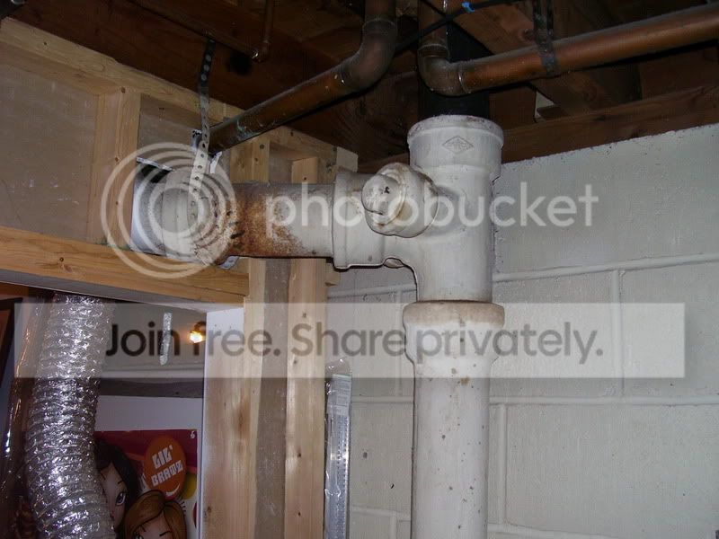

I'm getting ready to tackle this project but have a few questions about how to move forward.
What I want to do is remove the main cast iron sewer drain in my basement and install a pvc pipe in between it and a cast iron stack going to the roof. Is this ok to do? Any recommendations?
Thanks in advance...

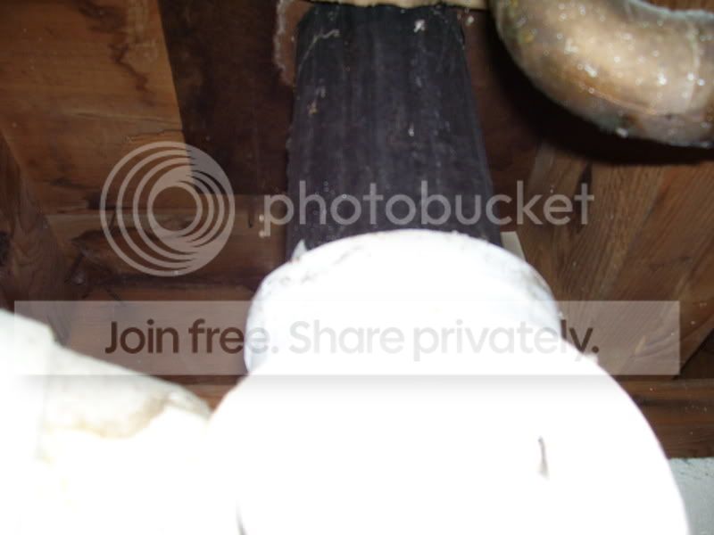

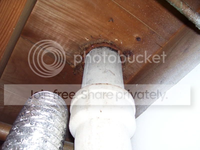

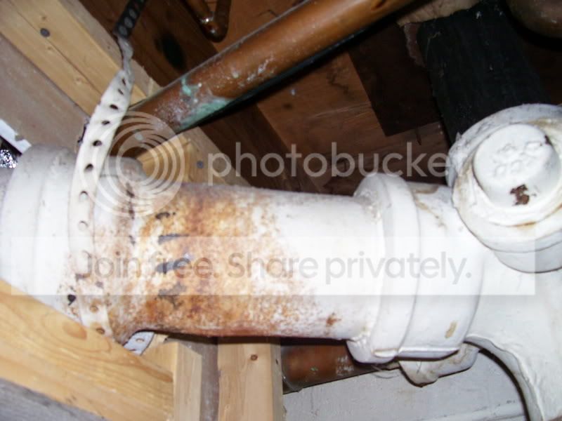

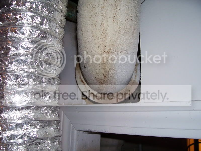

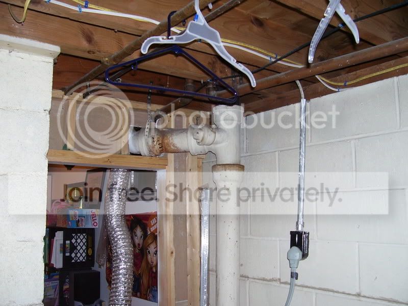

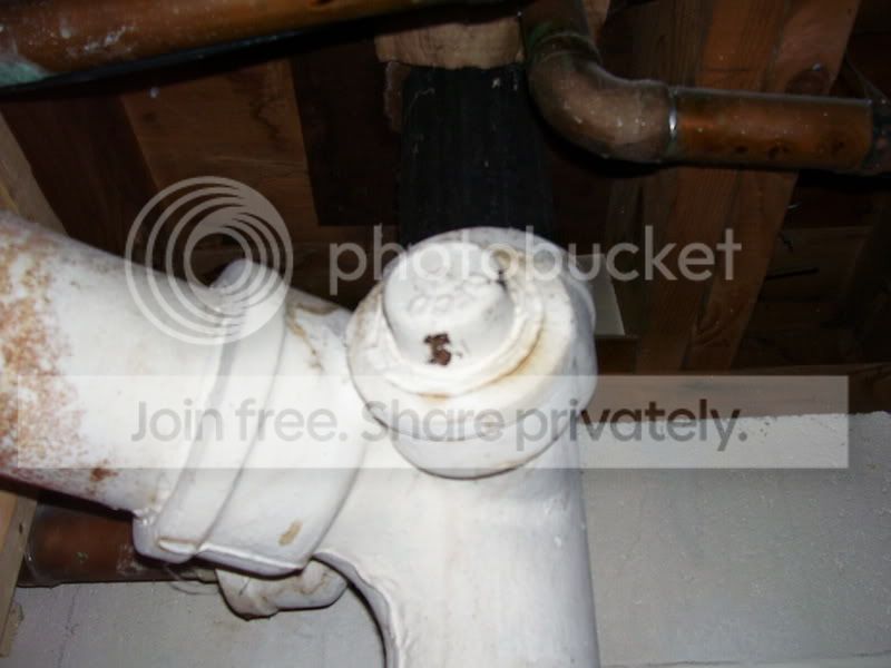

I'll post some pics in 30mins, maybe you can suggest another route to take. What I'm trying to do is add another bathroom, and I need another drain for the toilet..

Are my only two options:
1. melt the lead in the hub and go the donut route?
2. cut the hub and use a non hub coupler?

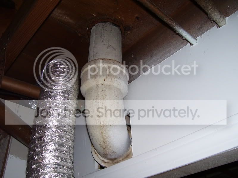

But it really isn't pvc under cast iron..
You see where the cast iron elbow is for the toilet drain? Why can I melt the lead in that hub and install a donut, a small section of pvc and then a pvc wye for the two toilet drains?
