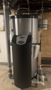

you should take some pictures of the hot water heater and ALL
the surrounding piping going in and out of the unit
and post them here for people to see.........

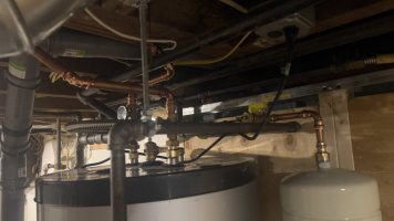

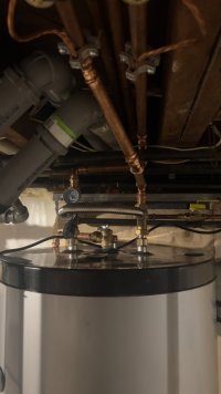

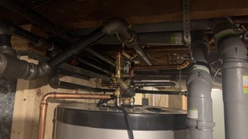

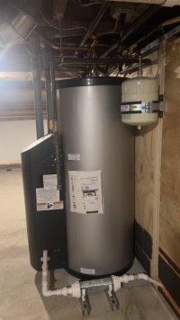

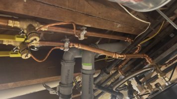

Hi, @Master Plumber Mark! Here are pics of the unit and piping -- we don't see any galvanized pipes? Tell me if you see anything!

looks like they spent a fortune on propress fittings... which is ok
that is an expensive heater and it looks to be installed pretty well.
I guess you can check off the gas pipe or galvanized pipes leaching into the system..

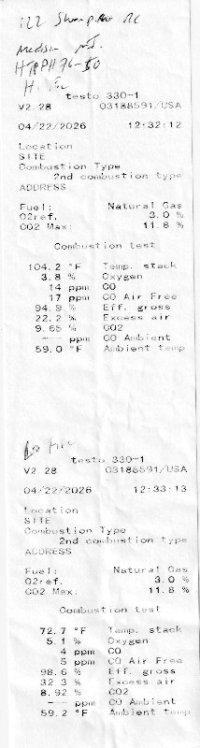

So got the new unit installed this past Wednesday — but by Sunday we got an error F82, "an unstable flame lockout." We reset and actually had the plumber come in to tighten one fitting that was leaking on Monday… And he blamed the errors on the electrical anode and also the gas company, saying we need our regulator checked — but that sounds fishy, because we never had a problem with the old unit functioning (it was only dissolving). It's now two days later and we got the error again!
My husband and I ran tests, and this F82 appears every time the unit goes into high fire mode. He ran the unit with and without the electrical anode attached to the ground, no difference.
Do any of you have any advice for me? Now we are out of warranty and I want to cry. Thanks!

Pic 2220 there is cap on a nipple top right what color is that nipple? Looks black.
F82 unstable flame. Nowhere on the burner setup shows gas pressure. That's the first thing I'd look at. Inlet and outlet gas pressures. On high fire.
Oxygen is lower than I'd like to see on the high fire test. What is the outdoor termination like? Hopefully you're not pulling exhaust back into the intake.
