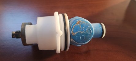

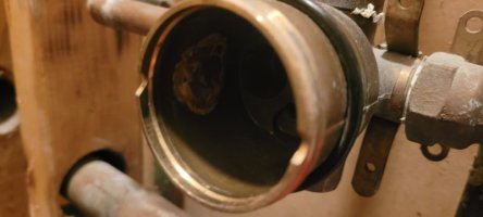

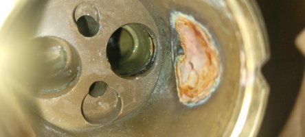

I have a 18 year old Delta Shower Valve Body 1300/1400 Model. I am redo the shower enclosure and figured I would change the valve cartridge although not leaking. When removed, the sides of the valve body had some corrosion where the sides of the Housing assembly are closest to the valve body. Wondering if this warrants replacement of the entire shower valve body assembly. Photos attached. Thanks.

If the deposits can be cleaned up then the valve body itself should be fine. The only parts that really create a seal are the two inlet holes in the back on the left and right and the front of the body. I'd probably want to knock off the large chunks so that they can't build up further and connect to the new cartridge and lock it in.

Thanks a bunch. Cleanup best I could with some WD-40. Then applied plumbers silicone grease to inside of the Valve body. Gave a test before new cement board and shower enclosure up. No leaks or issues.
