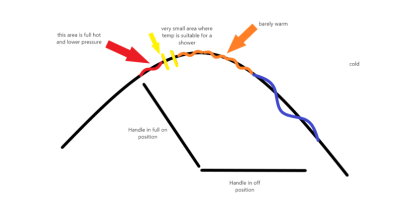

the main problem is that there is a very small window of water suitable temp wise for showering. The water does get hot enough after that small window it is just straight hot water at lower pressure.
and, that is with the temp adjustment on the cartridge turned all the way up. In fact I think I have it more than all the way up. its literally turned as far as it will turn, and doesnt drop back into place but still works.
sorry for the pictures, I just think it helps what Im saying

I like your 1.png drawing.
