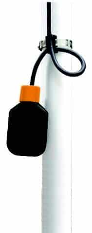

You could tape the tether to a plastic pipe, with the length selected to not fall in, that you insert into the tank. The longer the tether on the float side of the tape, the more hysteresis/deadband. So I am thinking you would use a fairly short tether, but not so short that the tether stiffness is a problem.
https://www.sjerhombus.com/support/different-types-of-float-switches-and-what-they-do/
A low current switch would need a relay/contactor to actually drive the pump.

https://www.pumpproducts.com/sje-rh...5-amps-max-pipe-clamp-mounted-20-ft-cord.html looks good to me. It can directly control a pretty good size pump at 230 volts.
