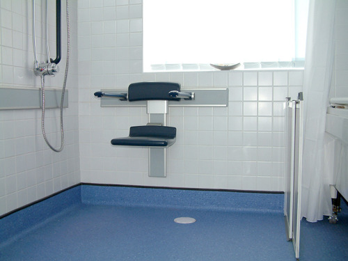

    Here is an example I found of a wetroom with a non-tile floor.
    [​IMG]
    The floor is something called Altro Cascade. I like the wave pattern on the wall. Must have taken quite a bit of work to get that done.
    Here's another example. It looks sort of like a hospital room to me.
    [​IMG]
    The floor was referred to as Altro safety flooring, but I think it might be the Altro Aquarius in either "dragonfly" or "penguin" color.
    I imagine getting a good seal around all of the edges-- particularly at the drain-- would be extremely important for this type of flooring.
