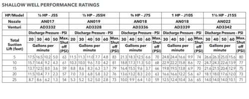

My 20-gal (20 yr old) tank piping needs replacing. Running 40/60 on a
Goulds J10s 1hp, 15’ well, 160 psi 1” poly pipe 100’ from well.
Read about the CSV but have seen many posts here concerning back pressure.
Would the CSV be ok?

If we look at the chart I attached. The Max shut off pressure is 74 psi. But doesn't the CSV increase the
back pressure when it's holding the flow at a constant?

The CSV will not create pressure, there will not be more back pressure than the max pressure of the pump. In this case as long as your pipe is rated for 75 psi or more there is no problem. With the CSV at 50 psi there is approximately 24psi of back pressure with 5' of head.

Thanks guys. A pump cannot build more pressure than it can withstand. Pumps are made to produce back pressure. That is what they do. Back pressure is good for a pump and will not hurt it. Too little back pressure is more damaging to pumps. There is the rare occasion of using a pump made for like a 600' deep well and installing it in a well where the water is only 50' deep, which is what cause high back pressure. Even in those cases the back pressure from a CSV will not hurt the pump. The CSV itself and the pipe are the only concerns with too much back pressure. BUT, it can happen. So, pump guys will use that excuse in every conversation about a CSV to talk people out of using it in favor of something much more expensive and shorter lived. As was said a J10S can only build 74 PSI max, which almost isn't enough pressure to work with a CSV. But it will be fine when used with a pressure switch set no higher than 45/65.

Ready to purchase the PK1A Pside-Kick Pressure Tank Kit components.
Now I’m a bit worried, as you mentioned the pressure needed to run the CSV.
My shallow well depth is 15-20 ft.
(Pump flow chart attached)
“As was said a J10S can only build 74 PSI max, which almost isn't enough pressure to work with a CSV. But it will be fine when used with a pressure switch set no higher than 45/65.”
Is there a minimum flow/pressure to utilize the PK1A? Will this definitely work with my 1hp pump?

At first you were worried about high back pressure, now minimum flow/pressure. Do yourself a favor and upgrade to a Goulds J15S with that PK1A, and enjoy the water pressure you have been lacking on the 2nd story
41,818
5,110
It is important that the pump can produce 1 gpm or more at 60 PSI if using a 40/60 switch.

It is not just because of the CSV, but jet pumps need to be able to build a max pressure 10 PSI higher than the shut off setting of the pressure switch.
