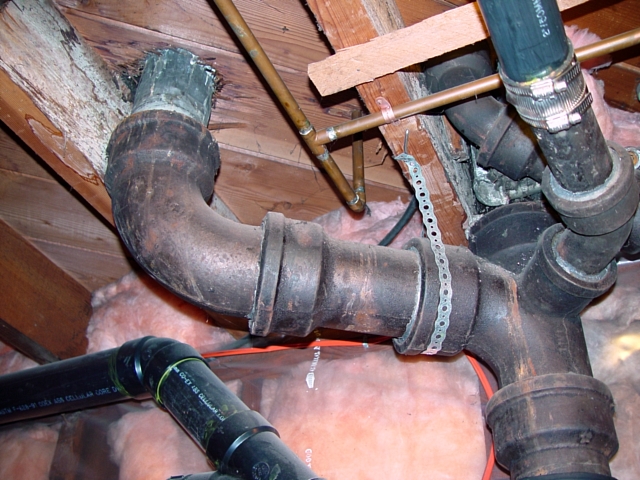

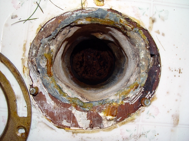

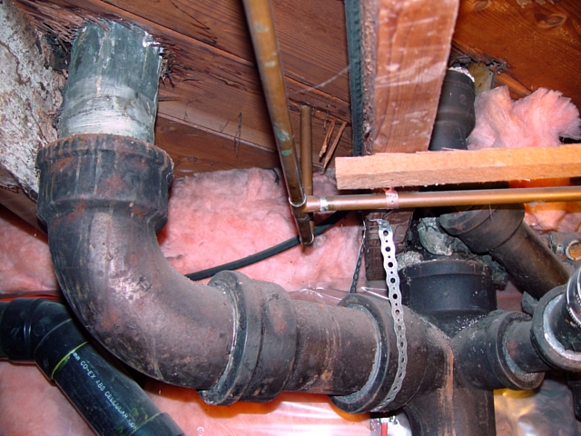

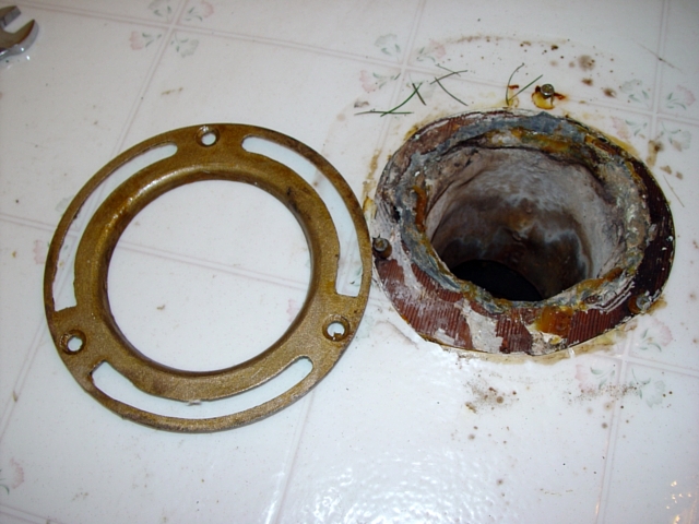

Thanks for all your help so far! Here is some more info.
The city building department was reluctant to issue a permit, even though the previous job was done wrong. "Any plumber will do it right. You don't need an inspection." Unbelievable...
The underside of the floor is exposed (unfinished basement) so I have good access.
Here are some pix.
1) Here is the brass flange, and the hole in the floor. Notice that the three screw heads are *smaller* than the holes in the flange.
2) Here is a closer look at the lead pipe coming through the floor. Notice that the lead pipe is flared against the wood cutout, but is not proud of the surface all the way around -> leakage.
3) Here is the underside (view from the basement). Notice the white residue all over the joist from long-term water exposure.
So here's what I'm thinking...
I should be able to rent a chain cutter for the 4" cast iron horizontal waste pipe (just to the left of the hanger).
I would then use a Fernco (or equivalent) to join 4" ABS onto the resultant cast iron pipe.
ABS 90 up through the floor.
Flange on the floor. Everything cemented together.

I'm not a pro, but if I was going to do this, I'd leave the 90 degree there, take the lead out of the vertical, get an approriately sized dougnut to attach the pvc there, and glue on the flange to it. It is possible that there is a brass sleeve in the cast iron, and then you could use a coupler to attach to it, rather than the doughnut.

If there is any brass there, it would be a short sleeve coming out of the 90 that the lead is attached to at the end opposite where the toilet was attached. Again, I'm not a pro, but if I was going to tackle this, I'd take a hack saw, cut the lead off maybe 3-4 inches above the bell of the 90, take a look and see if there is a sleeve, if not, pry, cut, hack the rest of the lead out of there so I could put in the appropriate doughnut connector and put in some pvc.

Stop Everything! I wouldn't do any thing that was described above!!! Dont Touch the CI soil pipe at all!!! Right where the 4" lead is wiped to the brass Ferrule cut off lead with a sawzall, leaving existing brass ferrule caulked into soil pipe. Then go out and buy what I call a "lead stub" which is a straight lead bend with plain edge on brass ferrule and a 4" no hub clamp. clamp ferrule to old ferrule and everything as good as new!
as far as compensating for a new floor that you will be installing in the future, they sell here something called a marble slab, which is made to be put down on wood fllooring underneath a toilet. it is nothing more than a peice of cultured marble approx 8" wide and about 18" long and 3/4" high with a 4-1/2" hole in it to let the lead pass thru. get your hands on one of these and put on floor before you solder your floor flange to the lead. When you tile your floor later on you can either remove bowl and slab and tile everything up and re-do floor flange or leave everything in place and tile up to the slab, leaving it there as a sturdy base for your toilet.
Another thing I have done many times in the past and it will/should last anyones lifetime as a repair to your problem is. Remove the existing floor flange, take a wire brush and clean the inside of the lead till it looks all shinny and new, then take a hammer and beat the lead outwards sweadging it so that it is now a little bigger that the outside diameter of the lead. Now go out to local plumbing supply and buy say 6" of 4" extruded lead pipe, a bar of torch solder, and some flux. Clean up the outside of the extruded lead pipe, flux up inside of existing and outside of extruded pipe and then tap the pipe into the bend aprox 2 or so inches. Now the fun begins grab yourself a piece of newspaper fold it up till its about a 2-1/2" square and rub one face of it insome dirt or coat with flux and use that as a wipping cloth. heat up your bar of torch solder till it starts to melt then heat the joint and start wipping! When your done your work should look look like the joint thats right above the cast iron pipe.
Again DO NOT touch any of the cast iron! The piece that is caulked into the cast iron is brass. and just join new lead stub which comes with brass "ferrule" already wiped on with a 4" nohub clamp, if there is a little flange at the end of the ferrule cut that off. go upstairs and mount your floor flange and enjoy a six pack!

JCH looking closer at your pictures it looks to me that whoever did the repair on this before used what is called a "tophat" which is nothing more than a 3-1/2" dia. piece of lead with a 2" wide brim stamped on top. kinda like what Abe Lincolns top hat looked like upside down! These are used by shoe makers to fix lead bends. You remove old flange drop this in flush with the floor and then mount your flange to floor using a couple of wood screws uses a deep wax gasket the kind with a plastic horn and remounts the toilet.
Also, its hard to tell from your 4th pic because of the angle it is shot at. But there looks to me as there is a wiped joint above the CI hub of the 90. If so that means that the piece which is caulked into this joint is a Brass Ferrule, you cannot wipe extruded lead pipe to a CI ferrule. If so just do as I said in my last post and cut off lead at this juncture and use a regular nohub clamp to join new lead stub.
Actually the lead pipe (what was left of it) was flared against the wood cutout itself. No brim. Problem was that the lead pipe wasn't long enough the come all the way through the floor. It resulted in 10 years of water seeping into the unprotected wood. Ugh.
You're right. When I torched off the lead, the ferrule was brass. I used ABS rather than a lead stub to go up to a new flange though.
