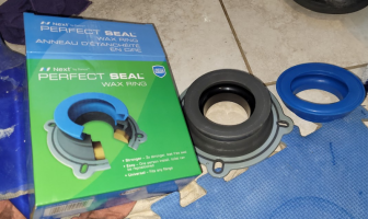

This is fantastic info. I pulled my Aquia I the other day for a bathroom re-paint and also to confirm a leak that I have suspected, as there was a little bit of seepage over time (no noticeable liquid) around the base of the front of the toilet. And yes, with the toilet removed, I can confirm that the subfloor is wet and there was a slow or periodic leak.
In my installation done in around 2007 by a rennovator, the flange is at the level of the subfloor, not at the surface level of the tile. On top of the flange was a thin rubber gasket/ring, followed by a flange spacer about 3/8 thick, followed by a thick foam rubber gasket as you can see on the right in the pic below - the beveled part is facing down. I also observed that the foam rubber ring had signs of wear.. probably becasue the toilet would rock (move) just a little if one sat down on it quickly. Below is a pic, and you can see the wear/damage on the foam rubber gasket on the right at the bottom-insight part of the gasket
Here also is a better pic showing the level of the flange relative to the tile surface
This below is what I had picked up a ways back as a replacement for the wax ring / seal...a "Danco Perfect Seal Wax Ring". Because my flange is below the level of the tile, the instructions call for the use of the blue extender as shown below. What i am failing to understand is how there is enough downward pressure with the PVC / rough in piece to truly compress the wax ring?
I had picked this up before I saw Jamie's suggestion (where flange is below tile) to "put a regular wax ring down 1st then a 2nd wax ring with a horn on top with the horn facing down"
Anyone have any experience with this "Perfect Seal" option? I am leaning towards heading out to the h/w store and going with what Jamie suggests.
